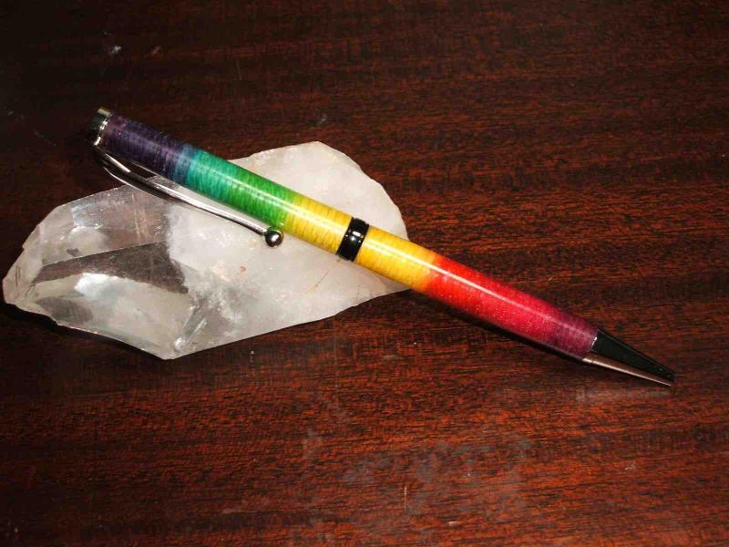

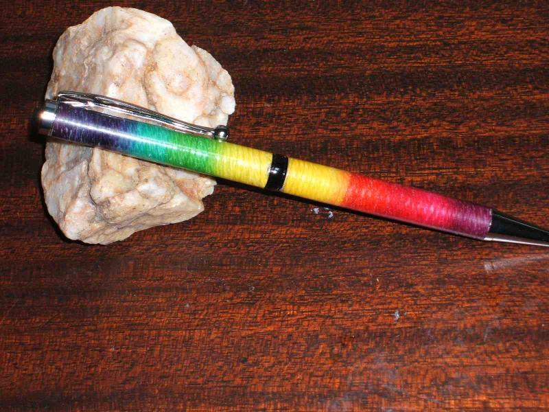

a knitting yarn wrapped whit gold slimline with a blk chrome c-b.. thin ca not cast,, polished with plast x
thanks for looking,,

Now that's a cool pen. There was a thread the other day asking about what kind of yarn to use for a pen like that. Was it a particular kind? Someone said that some yarns do play well with CA.

i saw that thread as well,, this is 100%cotton yarn, still sorta got warm with the first coating of the thin,, also dark solid colors show a lot of 'fuzz' .. i ve made a couple of these...

Nice job. I can only guess at the work getting it to look so nice and even. I hope you let us know how ladies respond to the pen. HWH

Beautiful, colorful and unique pen!! Great job. Good thing you took a picture...may not be getting the pen back. Doc
