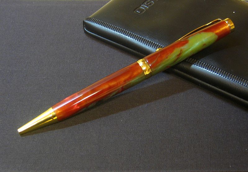

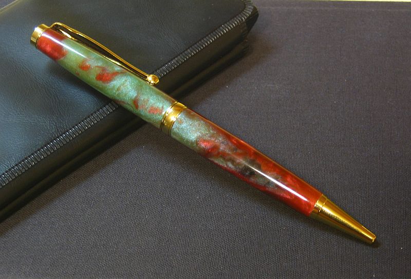

Here's the latest pen to come off the lathe. Learned a lot on this one, like I should probably always paint the tubes... You can see brass everywhere on this thing.
But also I was able to buff this one down a lot faster than normal. So that's an improvement. Also the fit at the nib is the best I've ever gotten. I can't even feel the transition. I think that's due to having brand new slimline bushings and pointing the nib end to the headstock.
I still can't turn off the acrylic worth beans... But it's only my third acrylic, so I guess I'm not doing too badly..
This is a freebie drippings blank from Exotic on a Gold Tn Fancy Slim w/ Comfort band.

Nice pen. Those Acrylic ones are a little hard to work with but with patience and time you will get it down. When mine get close to where I want, it does have some pits in it but sands out like it was never there.

"Drippings" is a RhinoPlastic product that is just what the name implies--the "leftovers" from the normal color pours are put into the "drippings" blanks.
So, it is probably best to paint the tubes a "generic" gray primer. Then, when the pen is complete it is a "surprise"!!
Of course, the thinner the material---the more you will see the tubes.
Your use of it to "practice" is a great idea--low cost--- turns nice. Voila!!!

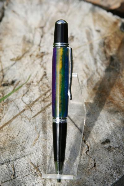

I also recieved a drippings blank, mine had a ton of yellows and gold flake to it so I didn't paint the tube or the blank. The reflectivness of the brass tube really made it pop!
Yours looks great!
