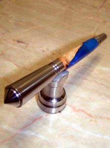

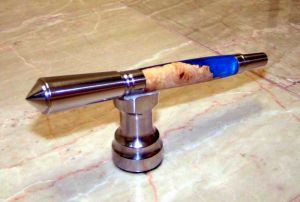

I know you guys thought I was washed up so I built this one special, its not my usual style but this one is for my little girl's birthday (she is 25 now but she's still my little girl). She is a PA (Pen addict) just like my wife :) It is a purse pen from scratch, everything on this pen was handmade including the worthless wood pen blank, I built it from solid 316 stainless steel and the blank is Alumilite and cherry burl. Hope you like it>>>>GEBC :cat:

I am loving everything... but the cap. I am in awe of the talent it takes to make it (everything including the cap) But the cap well it looks too heavy for the body and well reminds me of a dead center. $.02

The cap is hollow all the way to the tip so it is not very heavy, she wanted a "Magic wand" so I made her a pen with a magic wand'ish type cap (If there is such a thing LOL) I have over 2 days in this one and she just loved it. She is my biggest fan and my favorite critic :)

Jim, great to see some of your work again, neat trick using HDPE for a friction liner, the pen is superb, I'm sure your little girl will love the pen.

Jim that pen is awesome, I especially like the friction fit idea of the cap, your daughter will love it I`m sure!

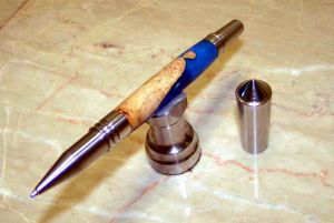

can I see a pic of the inside of the cap? :)
I already gave it to her but here is a picture of a pen that I used a similar technique, I thread the outside of the polyethylene bushing so the Ca glue has a place to go. The glue will not bond to the HDPE so the "Threads" hold the glue so it can bond to the stainless cap. The only way to remove the polyethylene is to drill it out. It really work's great :)

I love the idea of friction fit cap! And I can "see the 'Magic Wand'." Its really quite clever! How long is it?

Cathy, thanks for the kind words, the pen is about 6 inches long, the barrel of the pen is just over .5". I used stainless tubing for the spine of the pen, it blends in nicely with the translucent blank :)
