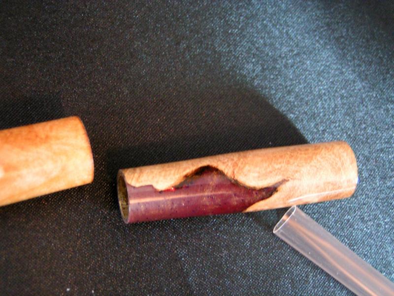

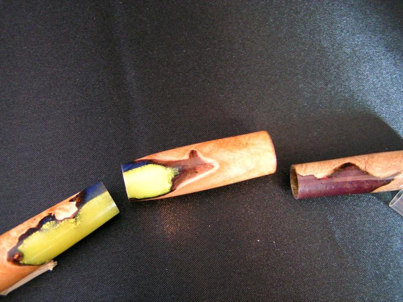

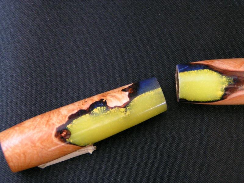

I had the Artstuf.com powered dyes already so I went to use those in alumilite casting my first ever worthless wood (shoutout to Curtis for his instructions). The alumilite worked great and I had no problem there, but I noticed the powder dye was not mixing thouroughly enough and you can see chunks of dye once turned. I don't think it's a mixing problem b/c I mixed them for probably 5 straight minutes. I think the dye itself is not fine enough. The yellow dye was the worst, very chunky. The plum color was actually a blue and red I mixed together, but you can see there was one little red chunk that wanted to stand out. Maybe the dyes are too old and are clumping together? Maybe I need to grind them up a bit to make them finer?
