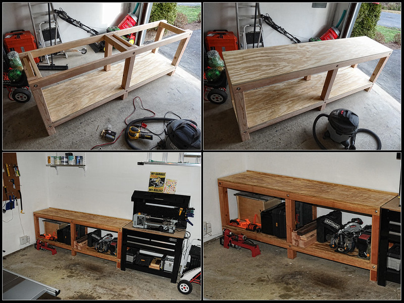

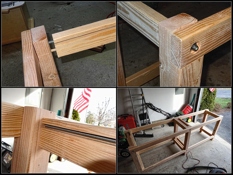

So I took some time off over the holiday season and realized I needed a workbench to start things back up after moving into the new house. I came up with a pretty simple design and here are the pictures.
Dimensions:
8 foot wide
23 inches deep
35.75 inches high
Material Used:
1 ea. 8x4 Sheet of 3/4" plywood
3 ea. 4x4's
6 ea. 2x4's
6 ea. 3/8" threaded rods at 2ft (12 ea. Washers/Lock nuts)
12 ea. 3/8" Wood Dowel Pins
I used a router, a table saw, drill, forstner bits, rubber mallet, and a chisel.
Happy holidays everyone!

Nice bench Wiset! Looks likes we were posting our new homemade bench photos at exactly the same time. :biggrin:

Oh now I see how you are! Get a brand new metal lathe and it gets to sit on the bench, while the ole trusted wood lathe now sits on the floor. Poor little fella. Great bench. Are you going to put a vise on it?

The finish was still a little wet :biggrin: She'll be up there boss! We'll see about a vise...every shop needs one so it's something I'll have to look into.

Thanks guys! Yeah, more tools would be nice, but for now it's about getting the shop in order. I have a couple things on my wish list so we'll see how that works out.

Put my bench to use tonight. looking at a Love Spoon we had hanging on the wall, I thought to myself "I can do that." well, after two hours with chisels, a bandsaw, and a Dremel tool I ended up with a cracked piece of wood. It felt good to try something new, but at the end of the day I realized one thing... I need a Scroll Saw before I can move forward with the next one. Bench worked well
