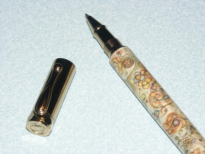

I meant the pen kit called the "Dayacom", The ones that timberbits sells.
Anyway I ordered a few, and yes the tubes are the same, just the bushings are alittle different.
