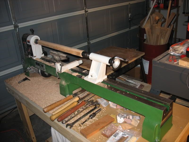

I have a Rikon also great lathe and if any problems they will help fast.
here is mine with extension.
