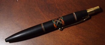

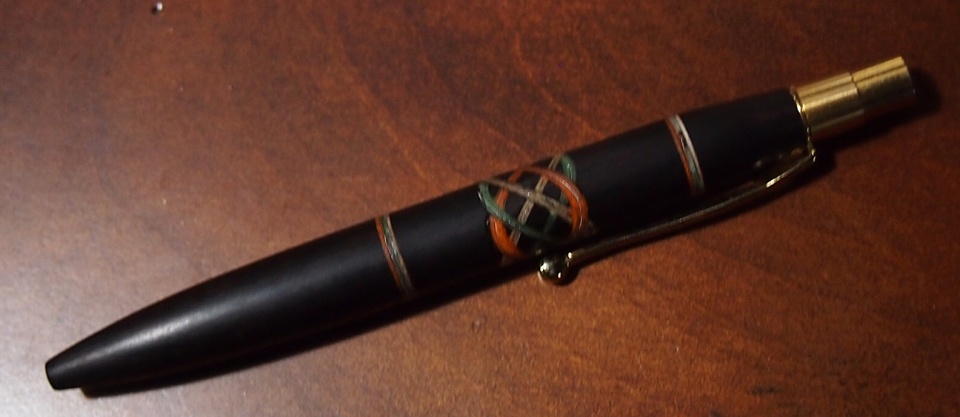

Mal:
Here are a couple of concept pens that I made using a clicker mechanism that can be used with your size constraints. One was made using a cross style refill and was done to see if I could turn aluminum on a wood lath. The second was made to see if I could successfully thread African Blackwood, use a Parker refill and incorporate a Celtic knot into a single barrel clicker. Both showed promise for further development and are on my list of things to pursue further. The Blackwood pen is a little thick and could be made thinner without the knot. It would be hard to put a finer taper on the nib end given the refill clearances with the Parker refill.

Thank you, Cody ... those are lovely !
The first picture is not enlargeable ... is it possible for you to make it enlargeable ?
Also, what is the max diameter of the Schmidt clicker mech ... or maybe it is on those websites you linked.
EDIT: I looked on the website ... it is 7.25 mm so obviously OK for a slimline size.

Here is the original post for the aluminum clicker, the photo can be enlarged there. Matching a clip to the mechanism is the one issue that I have with this mechanism. A slimline clip is close but that brings you back to a lower quality finish.
http://www.penturners.org/forum/f13/aluminum-clicker-138052/

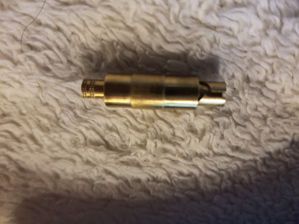

It would be easier to make a slim kitless with one of the click mechanisms i posted above and use a parker refill. With a twist I believe you would encounter some bulk simply just because of the transmission.

Thanks, Cody ... I wanted to see details of that clip. Where did you get it ?
You have nicely matched the size of the pen barrel and the click mech ... Like it !

The second I one linked to, the threaded one, is the thinnest and would be your best bet. I keep meaning to order some as well, but I don't like thin pens and generally don't have many customers that do!

I wonder if a tap is sold by the same vendor to mount this mech ?

This also a good source of info and supplies. Thanks Mal.
I ordered some of these with a tap.
https://richardlgreenwald.com/shop/push-mechanisms/
Ive put a Schmidt on the slimline pro. Very easy and a great mechanism but I'm not crazy about how it looks on this kit. It can't be buried easily because it tapers.
