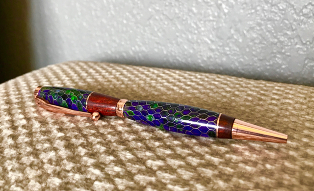

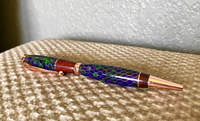

Rachgard
Jan 10, 2018
142
Texas
I have turned about 6 pens from honeycomb blanks I have made myself. One of which I turned down to a slimline, which I think was almost a dumb idea, even though the pen ended up very pretty. I do not clean the aluminum before pouring. I do use alumilite and a pressure pot. I also use a carbide roughing gouge and only take off a tiny bit at a time. I go into these blanks knowing that they're going to take a while to make. I stop roughing when I'm about 1/8 of an inch out, or if there's chunks flying everywhere, I'll stop sooner. Then I take off material with 80 grit sandpaper. Like I said, it takes a while. With this method, I'm able to consistently do bigger pens with no blowout. But with the slimline I found that even with the gentle removal method I could still see separation, so I had to part off the ends and glue everything again. I probably could have prevented it had I put on some thin ca halfway through like dieseldoc said. I usually ca the ends after trimming them. IMG_9769.JPG
I think alumilite helps, but you have to be really cautious on the removal as well.

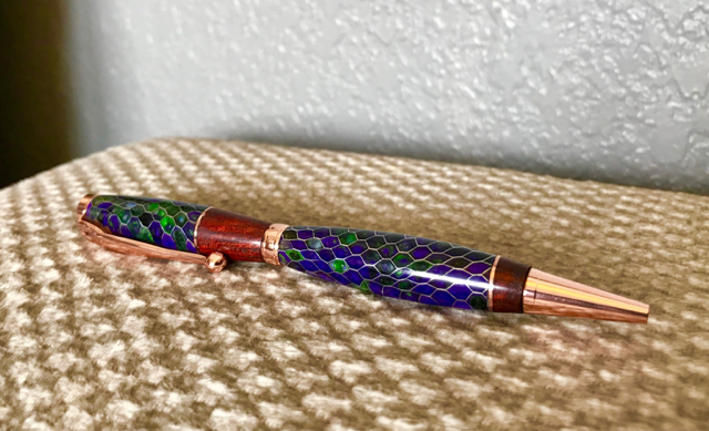

tomtedesco
Jan 7, 2015
3,293
Centennial, CO
I have turned about 6 pens from honeycomb blanks I have made myself. One of which I turned down to a slimline, which I think was almost a dumb idea, even though the pen ended up very pretty. I do not clean the aluminum before pouring. I do use alumilite and a pressure pot. I also use a carbide roughing gouge and only take off a tiny bit at a time. I go into these blanks knowing that they're going to take a while to make. I stop roughing when I'm about 1/8 of an inch out, or if there's chunks flying everywhere, I'll stop sooner. Then I take off material with 80 grit sandpaper. Like I said, it takes a while. With this method, I'm able to consistently do bigger pens with no blowout. But with the slimline I found that even with the gentle removal method I could still see separation, so I had to part off the ends and glue everything again. I probably could have prevented it had I put on some thin ca halfway through like dieseldoc said. I usually ca the ends after trimming them. View attachment 175014
Thanks for all the reply's, sounds like PR may not be the way to go. Interesting idea about sanding to final diameter, may have to give that a try.
