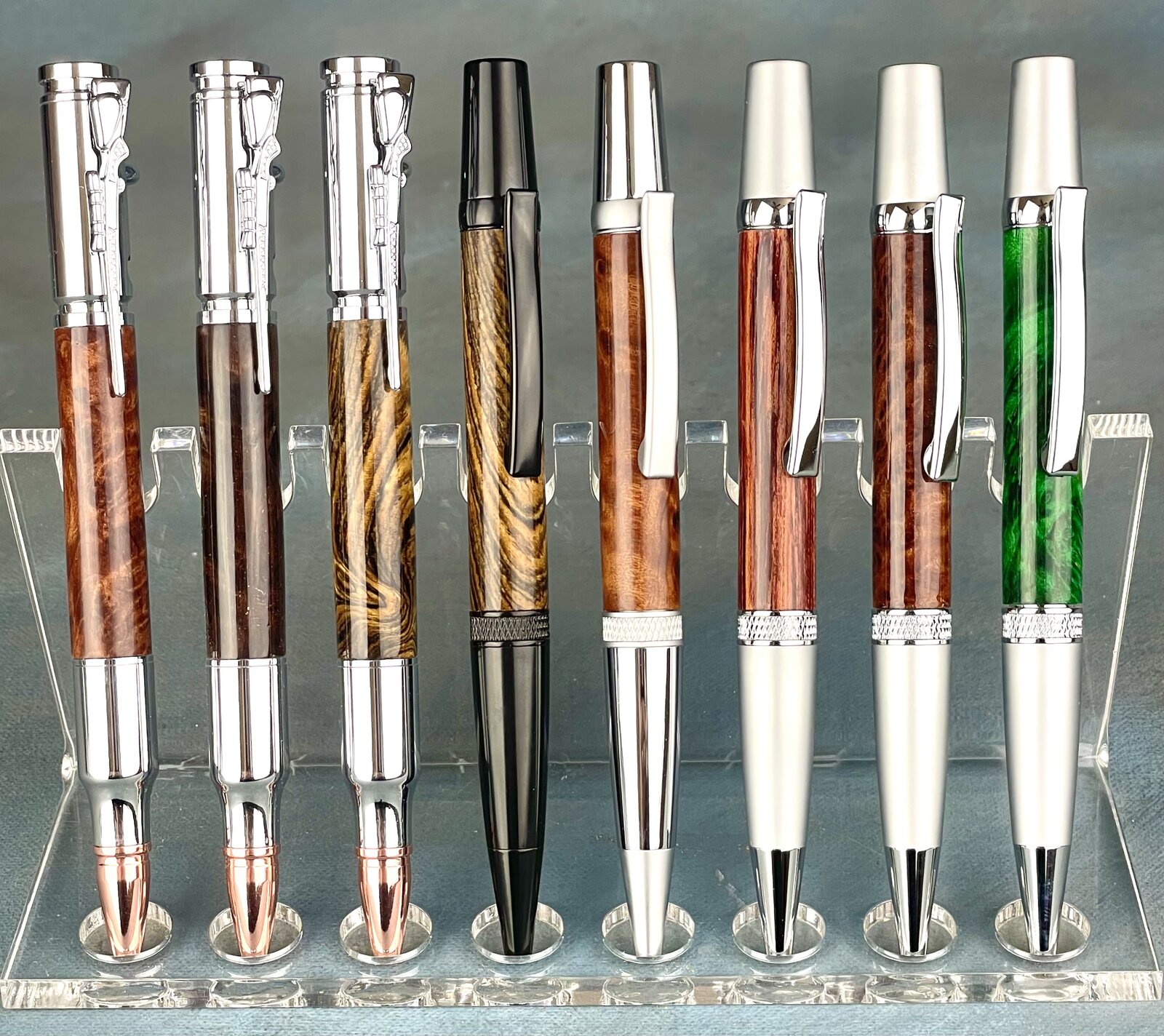

I don't usually time myself when making pens. That said, this group of eight pens were taken from sanded and alcohol wiped to this photograph in just under 90 minutes.
14 coats of CA glue for each tube (on the lathe)
Flush sand the ends (thanks Rick Herrell) on the lathe
Apply three coats of thin 5 cps CA to the ends
Sand using my 3D printed sanding bushings in the lathe
Buff on the Beale buff using my 3D printed buffing bushings on the lathe
Clean the tubes inside and out
Press on the lathe
Photograph
Hopefully sell this weekend.

The ends are critical to having a long lasting finish on a pen. Sweat can lift CA. This method makes sure the entire outside is coated with CA, the ends which are wood are coated with CA and the inside is brass. Everything is protected.

My technique:
I glue in all tubes with EZ Bond two part epoxy
Turn wood
Sand with 400 grit or finer grit
Clean with denatured alcohol
Let dry thoroughly
Apply EZ Bond thin 5 cps four coats
Spray with Stickfast accelerator lightly after 4th coat
Apply EZ Bond Pen Finish (thin 50 cps) and lightly spray with the same accelerant
Repeat three more times
Reverse lathe
Apply four coats of pen finish and spray after each
Reverse lathe
Apply two coats of pen finish and spray after each coat. For my high end pens I apply at least four coats here!
Let dry and cure for at least 15 minutes
Flush sand ends of tubes with Rick Herrell's jig and 220 grit.
Apply three coats of thin 5 cps to ends
Buff on the first two wheels on the Beale buff
Press and sell

When putting the tube in the blank or when spraying the outside for acrylic pens I use dental base wax in the ends. NEVER use CA to glue tubes in pen blanks. It will break far more often than epoxy.
The ends, as stated, get thin 5 cps CA.
