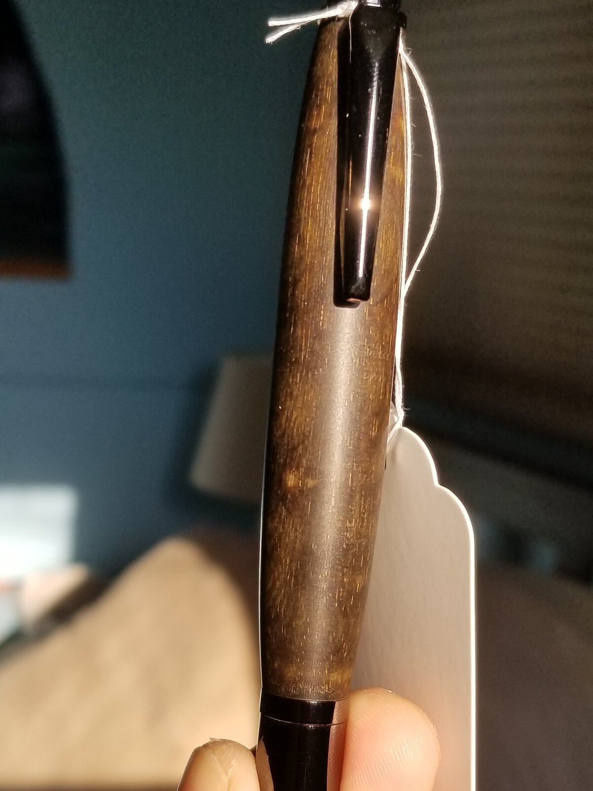

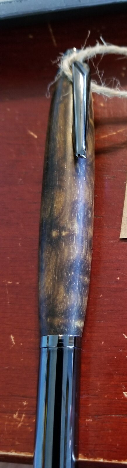

Does anyone know if Brazilian blackheart (Zollernia species; aka "pau santo") typically darkens over time? Although a beautifully figured Brazilian blackheart pen has been locked away with no exposure to UV, in just six months it's already darkened considerably.
I'm also wondering if there's a way to prevent this darkening. This particular pen has only a very modest coating of CA, I think, as I wanted a more natural finish/look. I just hate spending on a beautifully figured or colored wood, only to have it end up looking like any other piece of wood after a few months or years.
Thanks in advance,
G
Around 6 months ago:
Today (it's the same pen; I just changed the tag at some point):

Pretty much no. Some woods react to light as you know but others react to air, moisture, oxygen, 🤷‍♂️ or the finish changing the colour and there is very little you can do about it. You just have to accept that it may change or not use it in favour of woods that don't change much.
Yup, that's kind of what I thought. Just sucks that the beautiful burl or figured wood you see today might look like, well, just a dark piece of wood in a year or two or three.
G
