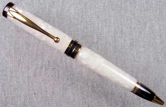

Mark, I prefer to make mine with white acrylic, but I've seen some nice ones done in Holly. I've been using the crushed white from Martin, but it's only 5/8" so it's only good for pens up to Baron and Jr. Gent size.
Here's what the crushed white looked like before I had it engraved. I forgot to take a photo after.

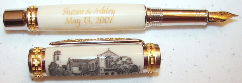

Here's the one I made out of alternative ivory for my sons wedding this coming Sunday. Kallenshaan Woods did the engraving. I have to agree about the gold colorfill, I would use something darker instead.
