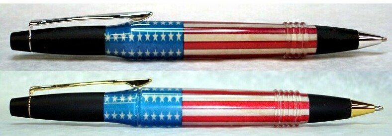

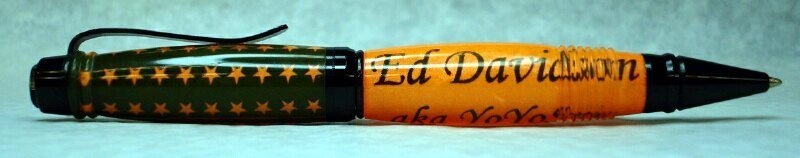

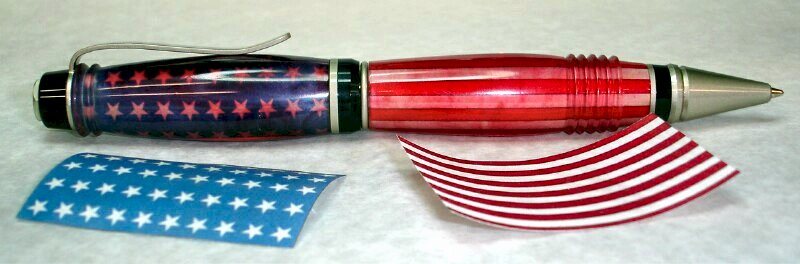

These were all printed on plain paper with an inkjet printer...the process works fine:
