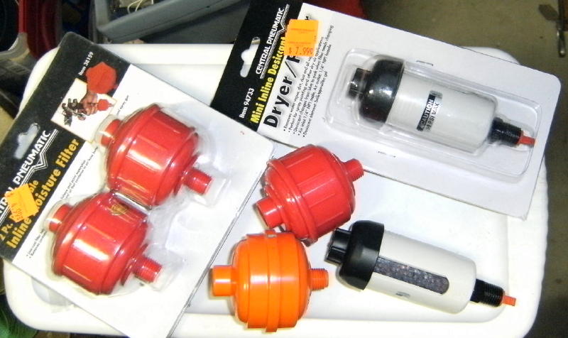

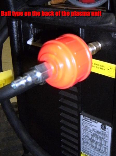

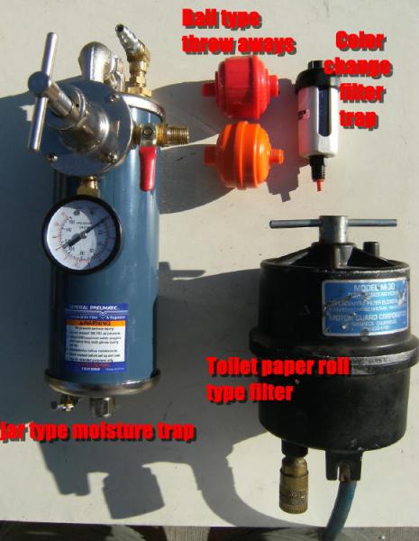

The oranges ball traps are place at the tool end. I use them on anything is moisture sensitive. the cream olor long ones are the descant dryers that the material changes color and you can dry it in the micro wave.

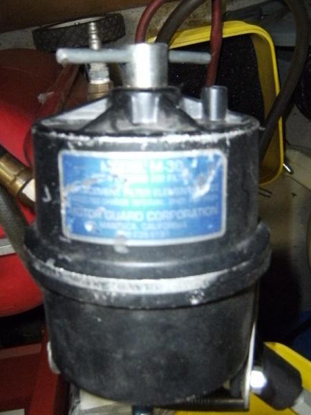

The tall blue one is the regular that is on my compressor. and the short fat one is the motor guard filter. Use only real replacement cartridges as people that use the TP rolls find out when they get wet they fall a part and you end up with a mess. I use that on my plasma cutter and on the hose if it is high humidity.
Motor Guard: Air Management
