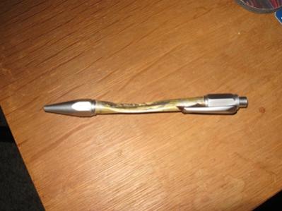

You drop it out of your pocket, it gets run over and wala easy to disassemble. I just pulled the nib and cap off, straightened the refill a little and now when I get to it I will build a new body!
