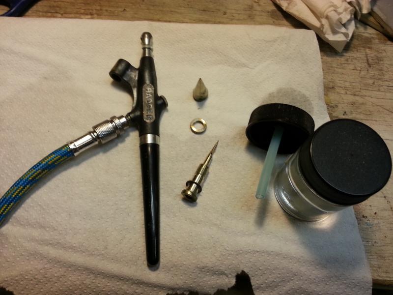

I did some playing around when I got home. Turns out there isn't much to worry about afterall; although, time will tell.
Here are the details:
Airbrush (got it from HobbyTown RC not HF, been awhile since I played with it)
Accelerator
The accelerator claims it's plastic safe and I used it on model car bodies so I don't think I'll have an issue with the tubing.

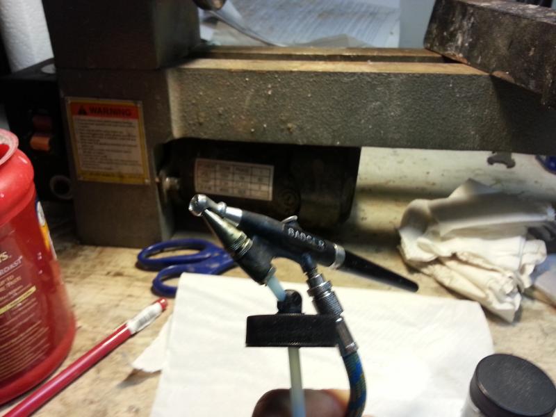

This pic shows the assembled airbrush: 20130514_215736_5.jpg

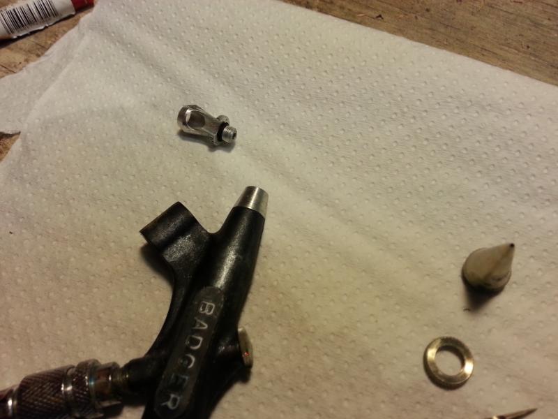

Disassembled to all components touching the liquid:20130514_215327.jpg
This is the only o-ring near the liquid:20130514_215412.jpg
I put a little of the accelerant in and it spayed in a very fine mist but the needle is adjustable to control the flow. I have a ball valve on the compressor that I can limit the airflow. I ran a little DNA through the airgun to clean it out afterward.

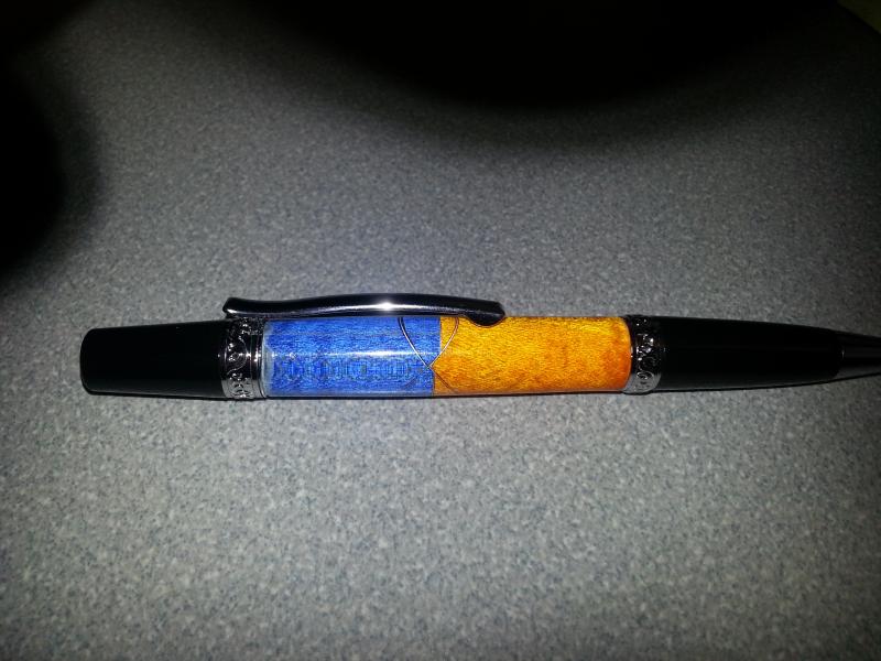

I put a dessicant filter on the line and it seems to work fine. I've finished 7 pens using the airbrush for applying the CA accelerator with the lathe on a really slow speed. I do make sure to spray it once before spraying toward the blank. It has really helped with my finish. I can get a good 7-8 coats on in just a couple of minutes with medium CA. I'm really digging getting to use the airbrush again! I clean it out by running a small metal bowl of DNA through it.
Here's one of the first ones that I finished. It's also an experiment with more advanced segmenting and trying to get my saw to cut a straight line, still needs a lot of work. I like it for a daily writer.

I like your segmenting blank. Did you match your insert to your saw kerf width? If you get a perfect match the blank does not get off set as you glue one part to another. The lines all match. I do not cut the blank into two parts. By leaving a skin of blank solid it holds the ends for perfect alignment and makes gluing very easy.
