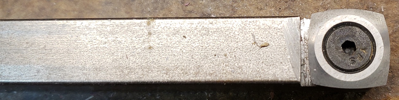

PSI does not make a negative rake cutter. So I was trying to substitute an Easy wood negative rake cutter. Could not find sizes on psi. Not sure easy wood has sized listed either. I can measure mine. But not having easy woods measurements leaves me with no answer.

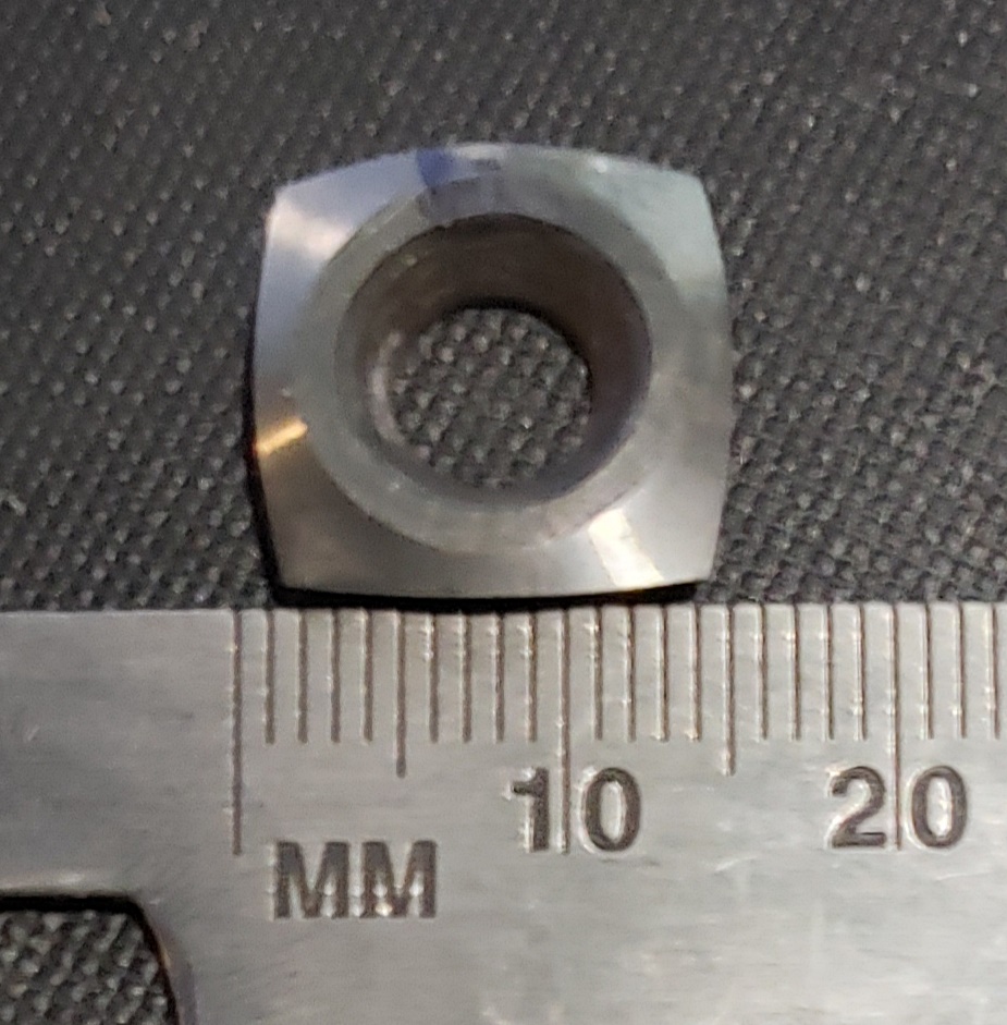

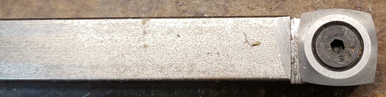

I use a homemade handle that is made from 1/2" square steel bar. The EWT negative rake cutter I purchased is the 2" radius Ci1, I believe. I bought it at Woodcraft. It measures approximately 15mm.
