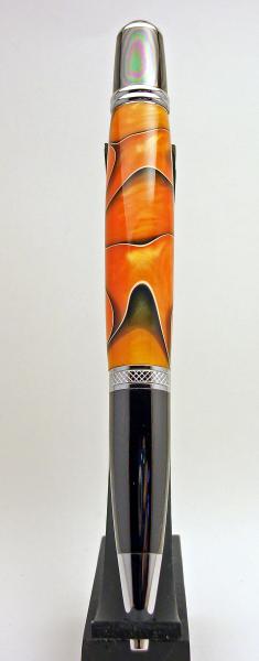

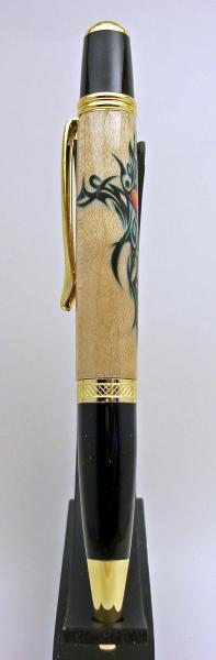

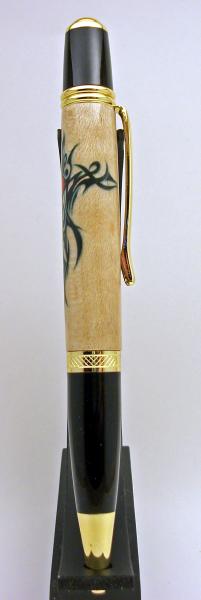

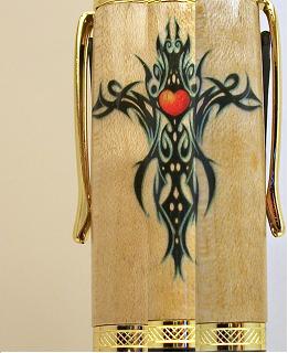

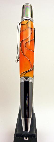

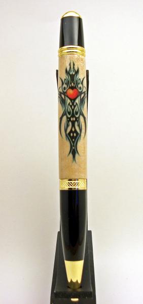

Gary Max sent me some Maple Blanks the other day so I used one of them to do this Tattooed Sierra. The Tattoo is a tribal cross with a red hart in the middle, it has a CA finish that was MM to 12000 then plastic polished. The second one is Orange and Black Acrylic on a Black Ti Sierra, it was also MM to 12000 and Plastic Polished.
Any Comments Appreciated, Thanks for looking. :)

I really like the tatto pen. Great job on both. Is hard to put the tatto on the round barrel?
NO, actually it is very easy, They come on white paper with a plastic cover sheet.The Pack I bought comes with around 50 tattoos. Just pick out the one you want, cut it out remove the plastic sheet, wrap it around the tube apply a wet paper towel for about 30 seconds then remove the paper and let dry. After it drys I applied 2 coats of thin CA with a paper towel let it dry, Then I applied 3 coats of thick CA, let dry, sand and polish.

Thanks Butch and Rob, Here is a paint photo I tried to splice The Three photos together to give a better view.
