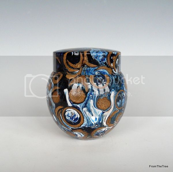

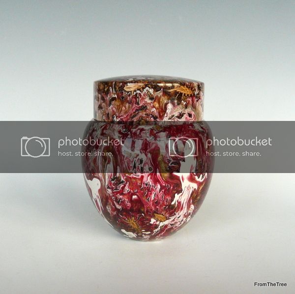

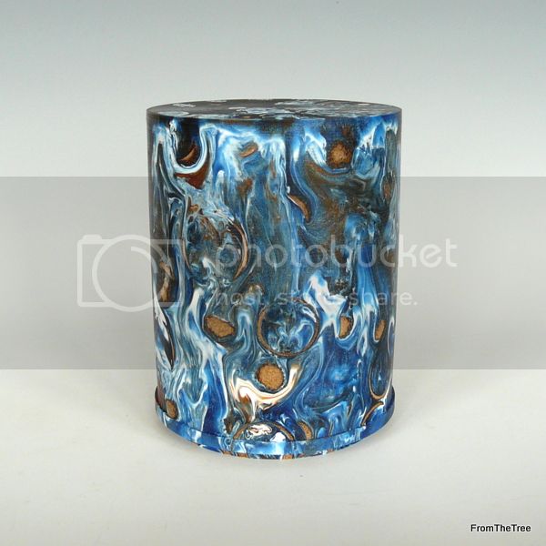

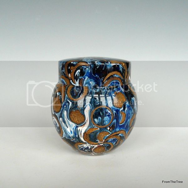

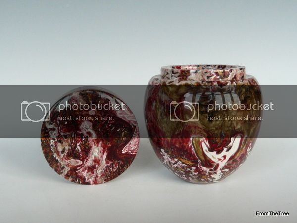

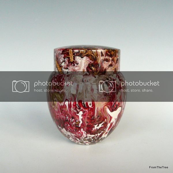

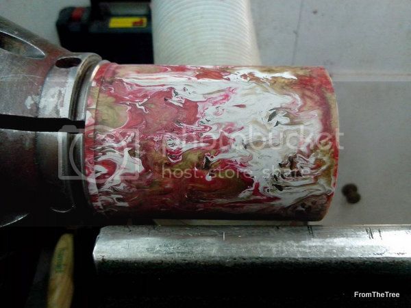

Wonderful turning George! Although not a big fan of 'hybrid' turnings, your's have convinced me that they are truly beautiful! Do you cast your own or do you purchase them elsewhere? If so, can you recommend a source? Are there 'special' considerations that we need to take in to account when turning them or are they very similar to wood turnings? Thanks for sharing and safe turning to you!
Apr 16, 2010
699
Leicestershire, U.K
Thank you for your comments
Old Codger: I cast my own blanks
They turn similar to how a dense hardwood (cocobolo, african blackwood, lignum vitae etc) turns.
You can use normal tools etc but I've found negative rake scrapers are the easiest to use and give the best surface finish.
The finishing of the blanks is where the biggest difference is- I've heard all sorts of methods from sanding sealer and friction polish to CA but i have found the easiest and best way to get a flawless finish is to dry sand to 600 or 800 then use buffing wheels and compounds. Obviously you can't buff the inside so I use abranet to 1000 grit then use U beauts EEE.
