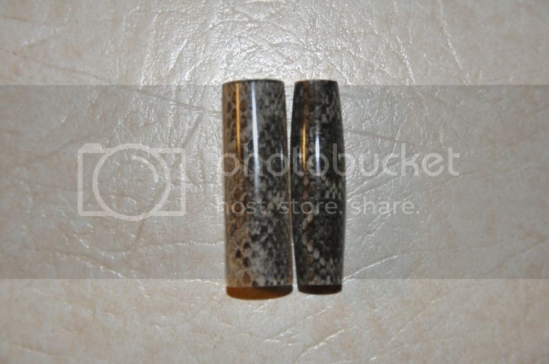

So, interesting side note. After turning said blank yesterday, I brought it up and laid it here on the computer desk. I just picked it up and it looks perfect.:confused: What gives? The others I have turned still look horrible but this one seams to have repaired itself somehow. I dont get it.:ghost:
BassBlaster
Mar 8, 2012
102
Grove City, OH
The blank on the left was one I turned a couple weeks ago, you can cleary see the seperation. The one on the right is the one I turned yesterday. It looked like the other one when I started this post. Not as extreme but a very clear seperation specifically on the ends. Now you can see, it has somehow fixed itself.
So, I went ahead and pressed it together and we'll see what happens with it. Worse case scenario, Sierra's disassemble in about 5 seconds!! Sorry about the horrible pics, someday I'll learn how to use a camera.

The blanks looked perfect before they were turned. The one on the left was destroyed on the lathe and I know what I did and why not to do it again. I just used that one for a side by side comparison. The only one I'm questioning is the one on the right. I have a few others, they just arnt pictured here. As for the casting, Everything I have cast so far has looked perfect when it came out of the mold. They have all been destroyed by me or the wife afterward.
