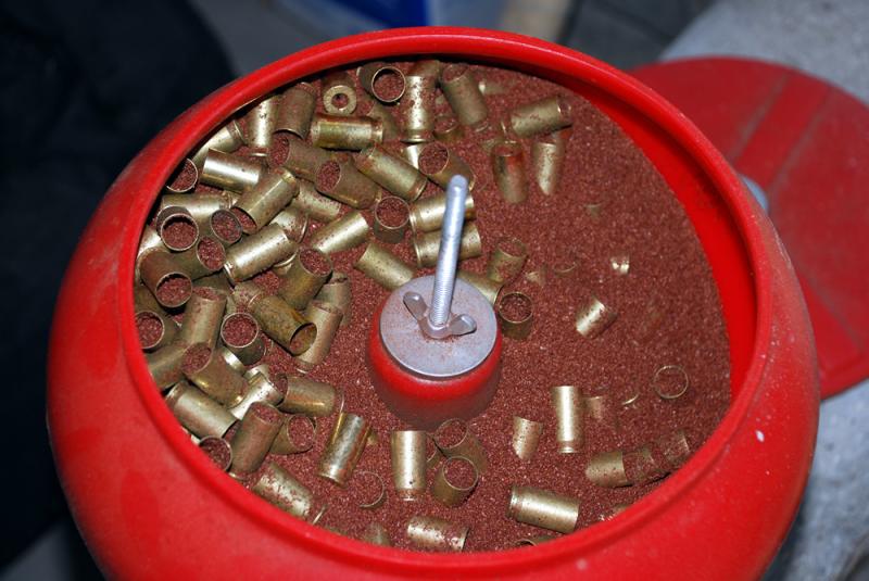

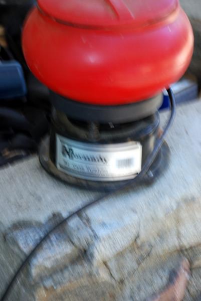

My brother in law gave this tumbler to me, loaded with shells.
What do you know about these machines? What do you use as material to polish the shells. Looks like crushed walnut.

I will be using it to polish .30-06 shells. I am thankful, frank-full and proud to have this machine. What a nice gift.

Actually that's not a tumbler, it's a vibratory case cleaner. The tumbler uses a small barrel and actually tumbles the cases.
Most people use crushed walnut or corn cob. Most of the media designed for use with this cleaner already come pre-treated with some type of cleaning/polishing agent. Some people also use pet bedding from wally world which is also crushed corn cob and add a little liquid car polish. If I'm cleaning dirty cases I'll use walnut and for just polishing I use corn cob.

Pet bedding. Interesting. Thank you.

John, some of the polishing media is expensive. Stay away from Lymans crushed walnut with the red rouge. It leaves red powder residue everywhere!
I'm currently using the pet bedding, which is much cheaper, and adding liquid car polish. One bag of pet bedding will last you a long time. Add a couple of teaspoons of car polish and let it run for about 15min before adding the brass, that should prevent it from clumping up. If the brass isn't too grungy it should only need to be "tumbled" for a couple of hours.
I should point out that the pet bedding I'm referring to is crushed or ground up corn cob. Not the cedar shavings

Wonderful. I am heading to Wal Mart tomorrow. Corn Cob.

As already mentioned, there are two basic polishing media, corncob and walnut shells. Their real purpose is to carry the polishing compound. You'll need to buy either impregnated media (which is expensive and the rouge is messy), or add it yourself.
Walnut shell media is sharper than corncob and will clean faster. Corncob is smoother and will yield a higher shine. Neither will polish as high as buffing or hand polishing.
Again, as already stated, you can buy crushed corncob or walnut shell packaged as birdcage bedding at a pet supply store much cheaper than media labeled for brass polishing. Both work, but they are not exactly the same. The pet bedding is more finely ground and can get stuck in the flash hole.
Personally, I buy crushed walnut shell at PetSmart and add ammonia-free brass polish that I buy from MidwayUSA (www.midwayusa.com). Initially, you'll have to add several tablespoons worth of polish and let the tumbler run to distribute it (wait until the clumps disappear) before adding the shellcases. The media can be reused until it becomes too dirty. Just add one tablespoon of polish each time.

Used to use crushed corn cob and Brasso in a commercial reloading company I worked for back in the '70's. Worked well.

I always used the crushed walnut shell and had many less problems all the way through the reloading process. The corn cob was always way to much trouble for me and did not last as long as the walnut shell. BTW, don't polish your brass with the same medium you use to clean the brass. Clean with no wax or polish, then use a different batch of medium to polish.
I charged my medium by using a hard bar of carnubea wax. Just add the hard bar of wax, tumble/vibrate for an hour or so, and off you go. No clumping problems at all. Experience will show you just how long to 'charge' the medium.
