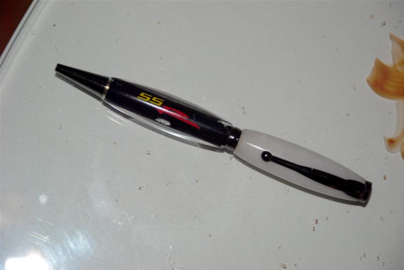

Air
Pens - 11-28-09 SSR Black-White Pearl Top.jpgSee that little bubble of air? How do I keep this from happening?
PTownSubbie
May 15, 2009
2,229
Chesapeake, VA
View attachment 20045See that little bubble of air? How do I keep this from happening?
Sit with your cast while it is curing. Have a piece of small diameter material (wire) and when the bubbles form, use the wire to remove them from the surface. This will move them off of the label.
Another tip is to put the label on the tube and let it sit for at least 24 hours. This has a tendancy to work out any air from under the label.

I know that if you turn the resin before it is fully cured (not just hardened) it can
twist, causing some separation between the tube and label. That can cause an air
bubble in a part that looked fine before you started. I'd probably leave the blank
for a few days after casting to make sure.
Some casters also paint the label with un-catalyzed resin before they pour.
