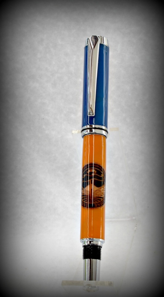

are you clear coating the decals before you slide them off? I spray 2 coats of Clear Krylon and let them cure between coats and have not experienced what you are saying? This is a University of Pepperdine decal on the lower blank in the school colors I was recently commissioned to do two such pens. Simply turn a bit under size, apply the decal and build it back up w/CA to the proper fit! Hope this helps, be well.....Jan
