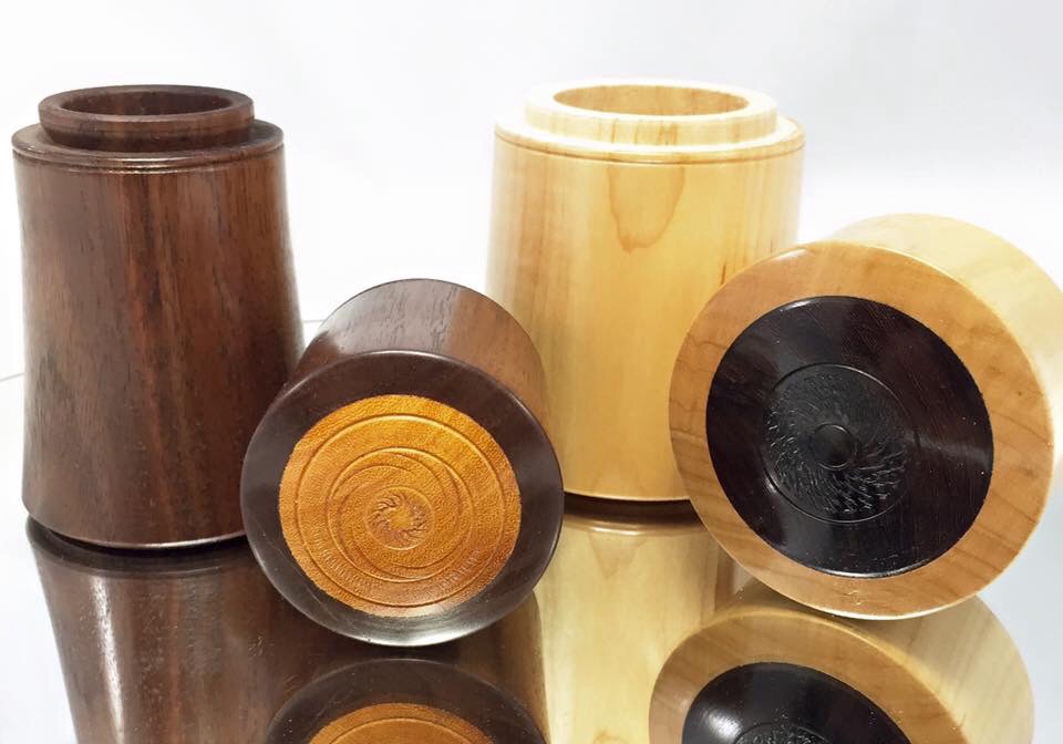

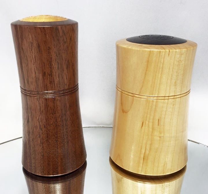

Walnut with Osage orange and Maple with African Blackwood. Pop fit lid.
Tieflyer Member Joined Jan 3, 2013 Messages 171 Location St. Louis Aug 14, 2015 #1 Walnut with Osage orange and Maple with African Blackwood. Pop fit lid.
ossaguy Member Joined Jan 3, 2010 Messages 1,370 Location San Diego Aug 14, 2015 #3 Tieflyer said: View attachment 136700 Click to expand... Wow,those are beautiful! I especially love the fine detail work on the tops.I'd like to learn how that is done. Steve

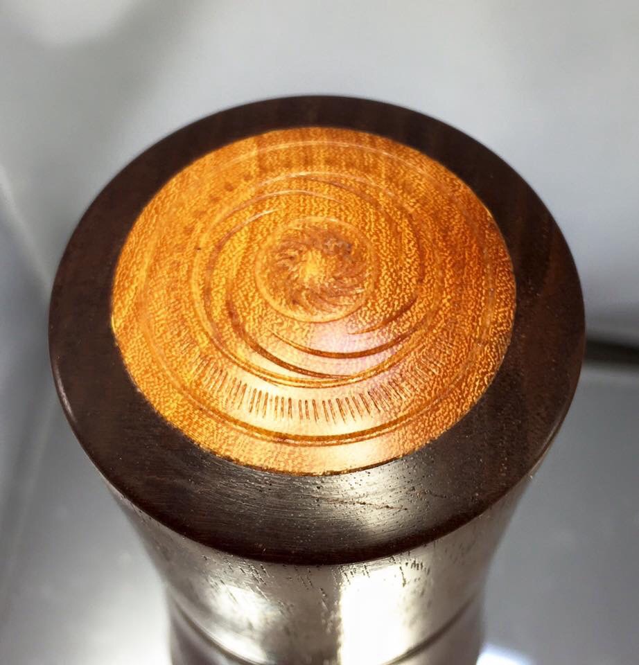

Tieflyer Member Joined Jan 3, 2013 Messages 171 Location St. Louis Aug 14, 2015 #4 Thanks Steve (ossaguy)! Top detail is done with a Sorby mini rotary detail tool on the Osage and a Wagner mini detail tool on the Blackwood. Keep your speed below 500rpm and know which side of the Sorby wheel is the bevel. Lol. Last edited: Aug 14, 2015
