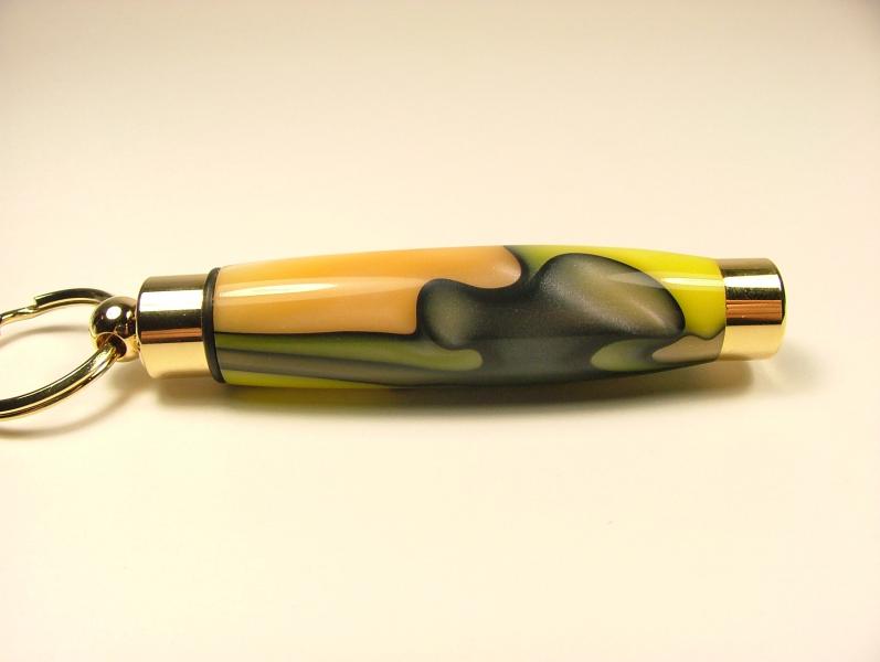

jaywood1207
Jun 18, 2006
811
Woodstock, Ontario, Canada.
I think it looks fine. Been doing it for a couple years and the last set of key rings I ordered from www.penblanks.ca had a smaller o ring included.

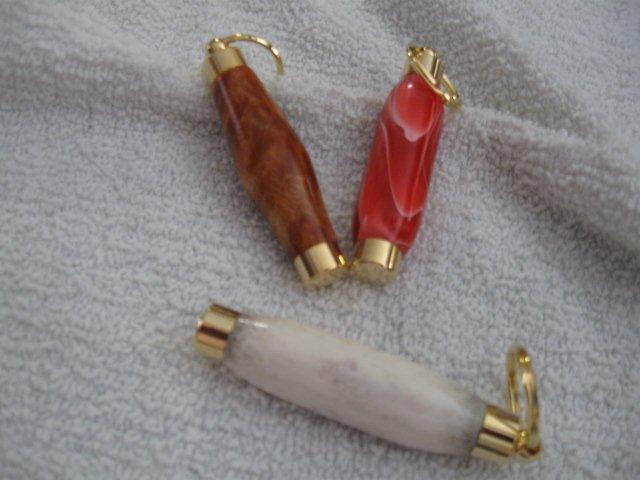

achennau
Aug 11, 2010
79
Mesquite,Texas
I haven't posted pictures before, but hopefully this works and I am getting some toothpick holder pictures on here. Thanks for looking if it works...
