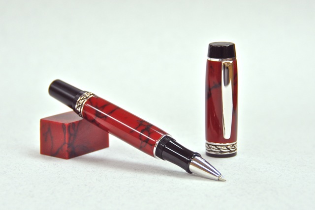

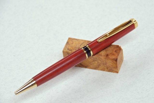

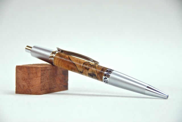

How nice to get back in the shop after the holidays, tho' I had to give it a good cleaning first before getting to play. The Bloody Basin Red Jasper is my first acrylic that actually made it to being a pen. I first had to blow up a computer chip blank that was supposed to be a Christmas present (insert long sigh here). The jasper is on a Olympian Elite2. The Spalted Pecan is on a Sierra Elegant button click and the Bloodwood is on a Hart Double Twist.
Thanks to all of you whose beautiful work has made me want to try this hobby! Your comments are appreciated.
John

John,
All three are very nice pens! My favorite is the the Red Jasper. Really goes well with that kit. Is the Jasper a Tru-Stone or an acrylic? Regards, Doc

Hi,Doc.
Good catch! The Jasper is actually a Tru-Stone. Still trying to get all of the lingo straight. I guess that means I still have yet to successfully turn an acrylic blank. Back to the shop!

I agree with Lee, the spalted pecan is stunning. Well, actually, they all are, but the pecan really pops.

Very nice pens there John. I think I like the Jasper the best personally. Nice fit on all the pens all the same. Nicely done! That had to really hurt losing the computer blank. It happens though, so hang in there and continue to do nice work!
