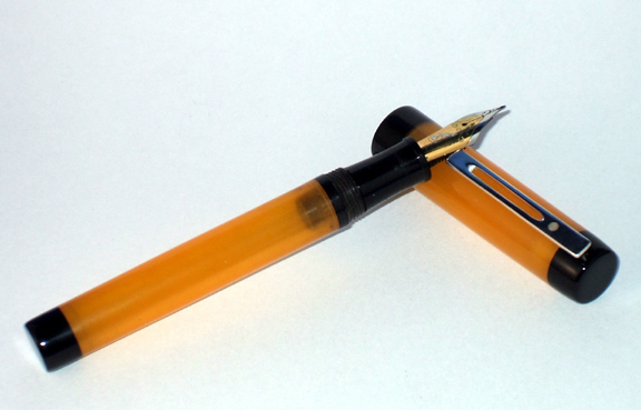

Here's how I did it - with tap and die. Inserts are ebonite.
attachment.php
attachment.php
Yeah, doing it like this was a last resort, but i was just going to segment the two materials rather than tapping and threading them. Dont see the need for all of that. Also then you see the black through the Bakelite( at least on yours and other more transparent Bakelite). Why did you decide to thread it all?
I guess i just wanted an all Bakelite pen, front section and all. I guess i am just a dreamer:tongue:
It's not all threaded - only the parts of the cap and barrel that mate. The other joints are mortise and tenon.
If you don't want to the black to show through, make the tenon on the more transparent material and you won't see it. I've made the mistake of doing it the other way a few too many times.
