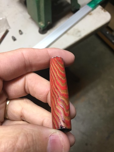

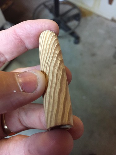

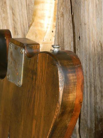

I'm making some pens for a local high-end men's store, and we're doing them from old, local barns and structures. I'll be doing Cortona click, Atrax rollerball, and Majestic Jr. fountain.
Where I need help right now is with how to do the blanks. These will all be old pine and douglas fir, and my initial thought was to just turn them as a normal blank. The problem, though, is that there's not much visual interest.
Then I had a bit of an epiphany today, so I tried an experiment.

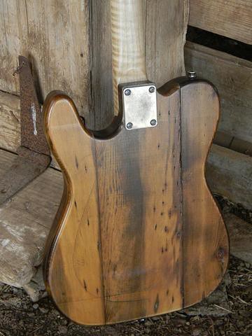

Using a technique I've used on guitar bodies, I was able to accentuate the grain to simulate what the board looked like when it was weathered on the side of the barn, and I'm curious what you think of the look.
I kinda dig it and think it would be a very cool look/feel. I'm thinking that it brings in the history of the wood and helps it tell a story, whereas my wife said she prefers smooth pens, so she probably wouldn't like one based on that.
What say you good folks?
Oh, and I was able to get some good coats of CA to finish and buffed out with 0000 steel wool, so finishing this technique isn't a problem.

First of all, those old woods can be cut at various angles to increase the grain structure and colours and you can also try making them with the finish you use on this straight grain pen and a gloss finish that way you will have 2 options on finish instead on only one, for repeated pens, the ones that will sell the most will be the ones you need to make more of, regardless what the finish or wood angle, is...!
For me, making a pen out of a "historical" (of any nature) wood should be looking as close as possible with is natural aged looks so, in this case, the technique you used in this pen is to me, one of the best finishes you could have done, however, I prefer gloss finishes generally but this is not a general pen...!:biggrin::wink:

I am not a fan of the look. But you are the one making. Who will ever remember the story. To me when you say highend store I see $$$ in pens that scream $$$$No screaming there. Ordinary wood pen. Splintering will be a factor with that many sharp edges in wood. Just my opinion. Good luck

I like what you've done, it keeps the story but adds a little character. The general consensus on the story woods is that they are usually boring, but boring woods with a good story sell better than beautiful woods with no story. I'd suggest pushing the story as much as you can - the specific building, where the wood was in the building, an old B&W photo... In addition to your darkening technique, you could also try crosscut or angle cut blanks, this can sometimes add unique character.
I love the accentuated grain in that pen. Looks great!
Your wife on the other hand, shows the difference in view points and likes and dislikes! Not everyone likes flat finished grain accented wood, or how to appreciate it. (The majority don't, IMO.) People sometimes think I am a 100% proponent of shiny CA finish. I am not. But when someone says CA is ugly or plastic looking in a degrading tone, I take a stand. It is ugly to them. It is not a blanket statement. Shiny sells much better. Sure, one can build a vertical market of clientele that like one kind only, and that is good. That doesn't mean the "shiny" or "flat" or "waxed" is bad or lesser.
Great work!

I like it; that has a lot of cool factor.

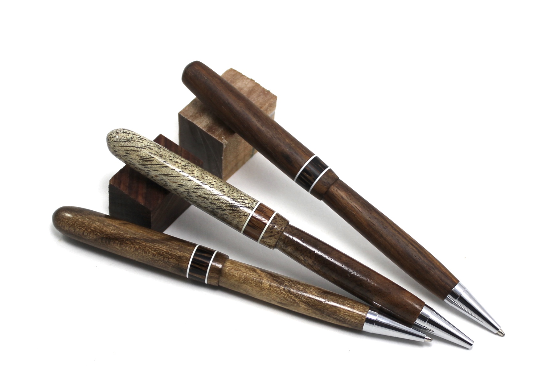

Well done, what plating are you going to use.
Thanks. For the twist and rollerball, I'm using chrome. For the Majestic, I'm using rhodium.
I like the look of open grain. I never fill the voids on a wood pen.
Thanks, Rocky.
I agree with Rocky - Nothing wrong with open grain, and a natural feel.
You may also want to consider some easy trim rings. Not that much more complicated, but a bit more planning, but a nice appearance for plain grained woods:

Thank you, Mark. I hadn't thought of that, but it's certainly an option. I'll do some more experimenting.

Thank you, George. I do have enough wood to try cutting at an angle across the grain instead of with the grain, so I'll add that to my experimentation set.
That's a bit of the issue I'm having as well. And that's the dilemma — how do you simultaneously let the weathered wood tell its story while also appearing high-end?
There's no risk of splintering. It's not like the wood is truly weathered and rough. The best way I can describe it is textured but smooth.
As far as who will remember the story, each pen will come with a custom card with the history.

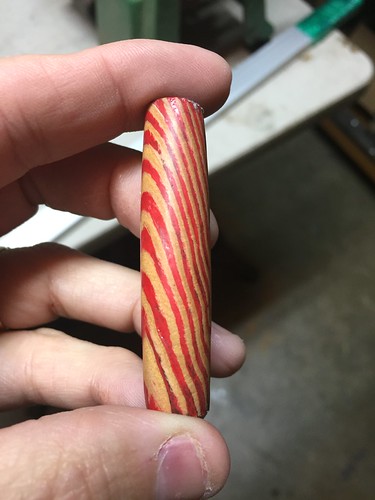

RogerC

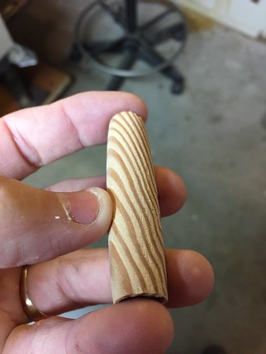

RogerC
Jan 30, 2017
149
Oklahoma

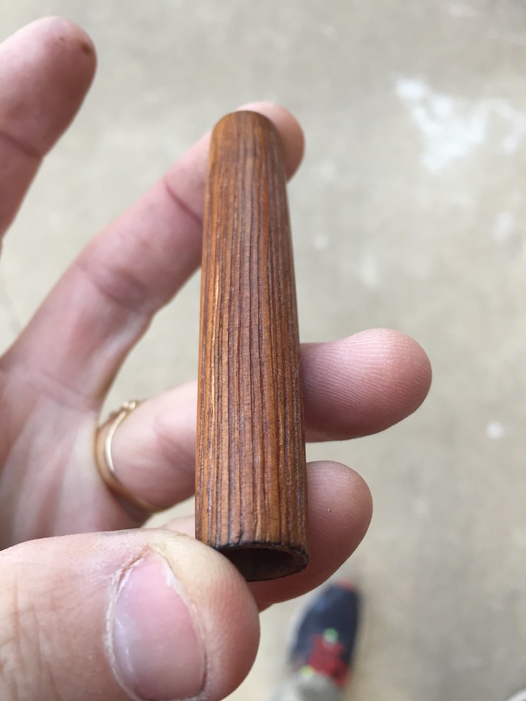

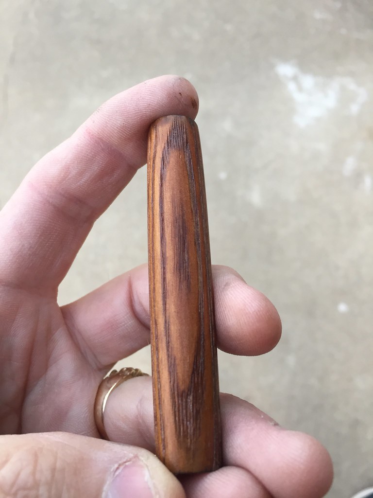

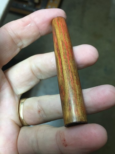

Ok, here's version 2. I cut the blank on an angle as suggested earlier, and I didn't dig the grain out so deep. There's also no dye on this one so we could focus on the technique rather than the finish.
I'm liking this version much better. The wood definitely needs something to add character in terms of color. I'm trying a wipe with red paint to hit the elevated grain and get it looking more like it did when it was still on the side of the barn. I'm just using krylon spray paint sprayed onto a paper towel, but it's not giving me the color I was hoping for. I may go ahead and get some milk paint.
Also, I think using a dremel with an abrasive sanding pad will do a better job of digging out the soft grain and leave it smoother in the low sections.

Sandblasting might give you the desired effect, I've never done it myself but it's an idea... I like the the angle cut better too.

You may not need to dig out the wood at all to get a highlight. I have noticed on both Oak and Chestnut barn wood that sanding at high lathe speeds will burnish the harder wood and make it darker, changing the character without digging out the softer wood as much. May achieve a look for you without as much extra work. I do like the angled cut of the second piece much better. I have also had success preserving worm holes, cracks, grain and such by putting thin CA in the hole/grain/defect then filling with medium CA until slightly proud. Once dry I sand lengthwise until back down to surface level then sand and finish the entire pen as normal. It preserves worm holes and cracks nicely but will make worm tailings and punky spots change color.

After you mentioned wanting the look of a barn, the idea of painting and distressing came to me also. The wood should appear gray. If you go that route you'll end up with a very rustic looking finished product.

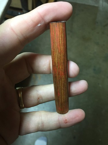

Here's a thought for an antique look. Put some fine steel wool in a bottle of white vinegar for a day and apply it to your blanks like wood stain. I've only tried it once on a wooden gate so you may want to test it out on a scrap piece before trying a blank. I don't know if it would look good on a pen or not... just a thought.

Sand blasting or media blasting is just another way to do what I'm already doing and wouldn't really change the end result.
I may give the burnishing a try to see what effect it has. Thanks

Thanks. I really dig the tin idea. I'll probably experiment with that detail for use on the highest-end pens.
Yep, I've got a batch brewing in the shop right now. It usually takes at least 4 days (I like to leave it longer) to get a good concentration. I've used that technique on a couple of guitars in the past with good results.
This was my first thought to use in terms of staining. Since it's a chemical stain, the solvent properties of CA won't disturb it. It doesn't work equally well on every wood, though.

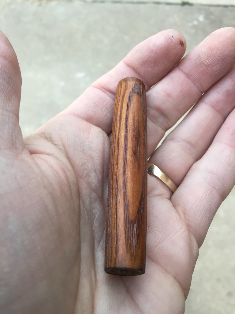

Ok, here are the latest experiments. I just took the 2 blanks from earlier, sanded them down and tried some different variations.
This is the straight grained blank with paint in the recesses, sanded back, and rubbed with the wood aging solution. It's definitely more rustic.
And this is the angled grain blank. Coated in red, sanded back to remove paint from the higher grain, and then CA top coat. No aging solution.
I think these were very successful. I'm going to pick up some variation of barn tin tomorrow to try a segmented version as well, and I'm also going to do some that are completely natural.
I figure I've got 3 different pen styles to do with 4 each of each style, so that lets me do several different finishes in each style.
