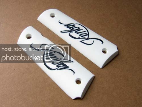

I didn't make them, but I thought they were pretty cool and this is just one more thing my brother uses his Corian to make, so I thought I would share.
These were made for a guy my brother works with and the gentleman belongs to several clubs and is an instructor. He also competes in different competitions and was once on a manufacturers team.

As someone who's made a few sets of grips, those look spot on. I almost always have trouble getting the holes drilled perfectly.

Looks like a nice set of 1911 grips. You wouldn't guess it's corian. How did he do the Kimber name? Decal maybe?

I asked about the holes and he said he uses a fixture that holds them in place while drilling. Also, he said that there are slight differences from frame to frame and sometimes a little fitting is necessary.

The Corian has a faint streaking in it similar to marble, but not as dark. He said he used something called a hot stamp machine. It uses colored foil and bonds the foil to the material. I guess it can also be used without the foil and it will just burn the image into the material.
He also wanted me to thank you for the nice comments. The recipient loves them.
