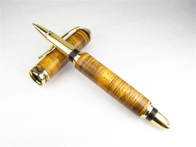

This one has been turned in X-Cut Zebrawood, then dyed yellow (gold) to increase the chatoyance and the contrast of the dark stripes. The plating is Ti. Gold.

Great looking pen. And I learned a new word, too! Thanks. =)

It's a GREAT looking pen. But, I'm amazed no one has commented on your turning skills!! Crosscut zebrawood is a BEAR! NICE job.
How many bottles of CA???:biggrin::biggrin::biggrin:

Hi Ed; That one is my 4th Zebra X-cut. I blew the one before it out, and the 1st 2 were both successes. I owe it all to my Sorby Spindlemasters.
Strange as it may seem, I never even thought of using CA while turning.
I finished it with 6 coats of 4 hr. dry poly. It still had some small open pores, so I sanded it back to rough it up, and then proceeded to finish with CA/BLO. There are still some minute (invisible to the naked eye) open pores showing under my 10 power glass, so no Ren wax on this one.

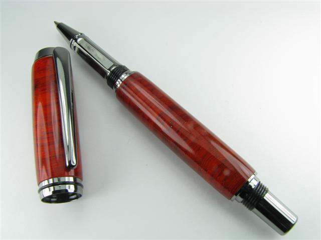

I meant to shown this one in my previous post.
It's a Baron Rollerball in X-Cut Pauduk. Most woods show up so much better when turned X-Cut.

That is absolutely Stunning!!! The combination of blank and kit are smashing! Great call on the dyeing, that blank looks great!!!
