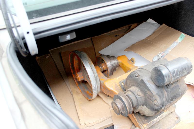

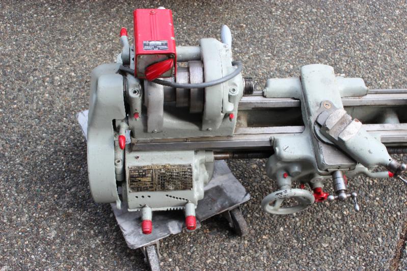

In the Seattle area.... South Bend lathes come up seldom...and when they do... they go for a premium price and they go quickly! I paid $450 for this one ... and it cam with nothing... and it came bare...lol (no chuck... no tool holder or tooling... wrench, thread dial etc) It did have the counter pulley and a motor that may or may not work.

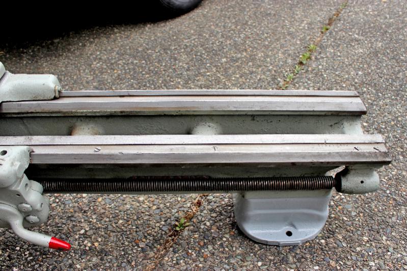

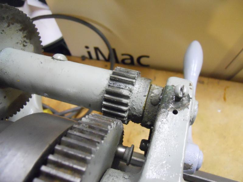

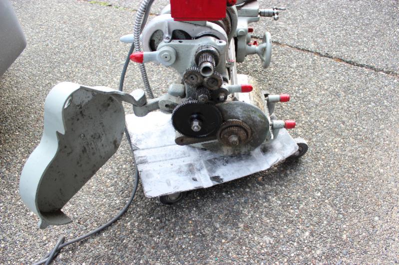

First up... the ugly.... I knew the 80tooth idler gear had a chipped tooth... but when i got her home and took off the bull gear guard... there was a tooth missing on the back gear~small gear. The Bed was dinged up around the chuck area.. and a chip or two here and there... all in all....I dont think to bad...(ive never run a metal lathe ... and this is my first to own one). Someone has recently try to do a drunken home paint job on it.... so i might strip the whole thing down and see if i cant get rid of some of the rough spots and smooth things out with one color....(it needs to be pretty...yes?)
This weekend i'll begin stripping it down....I have purchased the "rebuild" kit from "FleaBay"... with the manual and the oiler felts as well as the new thrust bearing kit and some new oil gits...(there was a broken one on the gearbox)
Currently...im checking with a friend of mine who owns a machine shop to see if he can repair the missing tooth on the back gear.

Is that a broken gear in the last photo?
Yes sir :frown: it is a sheared tooth.... it was one of the surprises for me after i got it home :)
Im currently checking with a friend of mine who owns a machine shop to see if he can fix it at a reasonable price... and I have been combing ebay to see if i can find one...( i did find one... but it was purchased with buy it now...AS I WAS LOOKING AT IT...hahahaha... it went for $175 (including the shipping)
