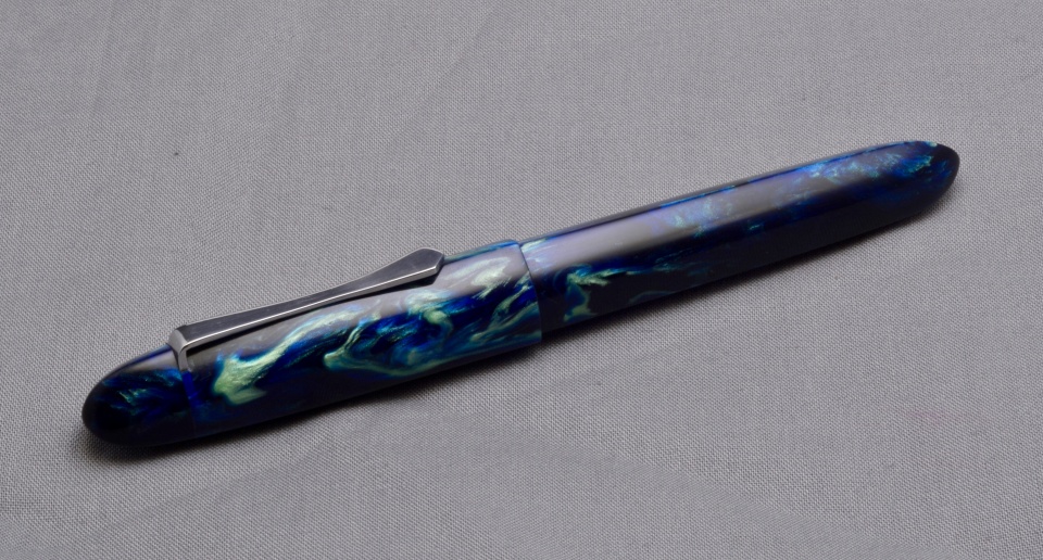

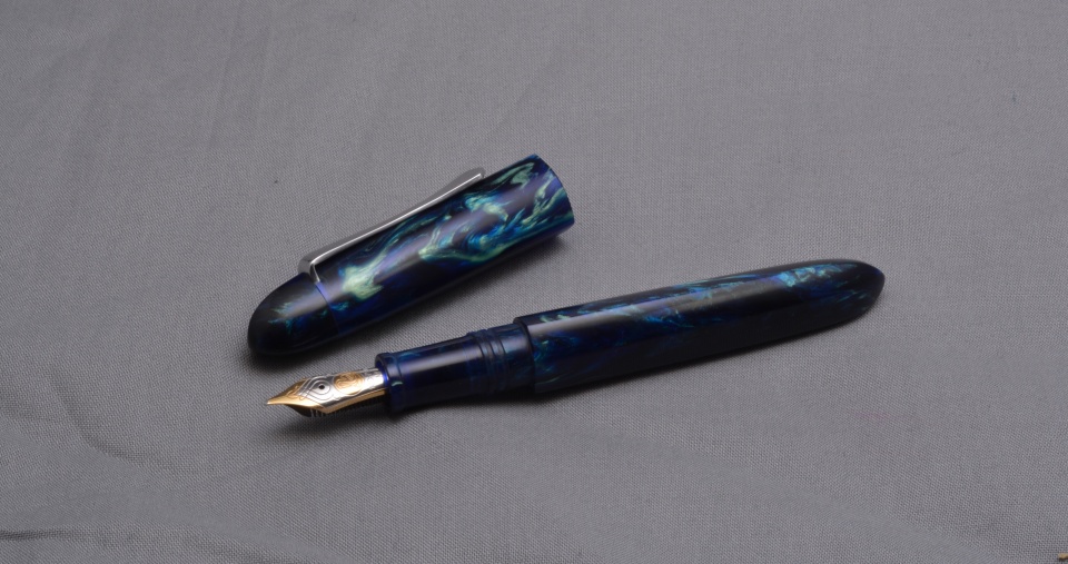

1. A commissioned piece in a resin that Jonathon Brooks cast, and the customer sent me. It's a three sided sculpted pen, and is fitted for a Pelikan M800 nib. I fabricated the clip from stainless steel.

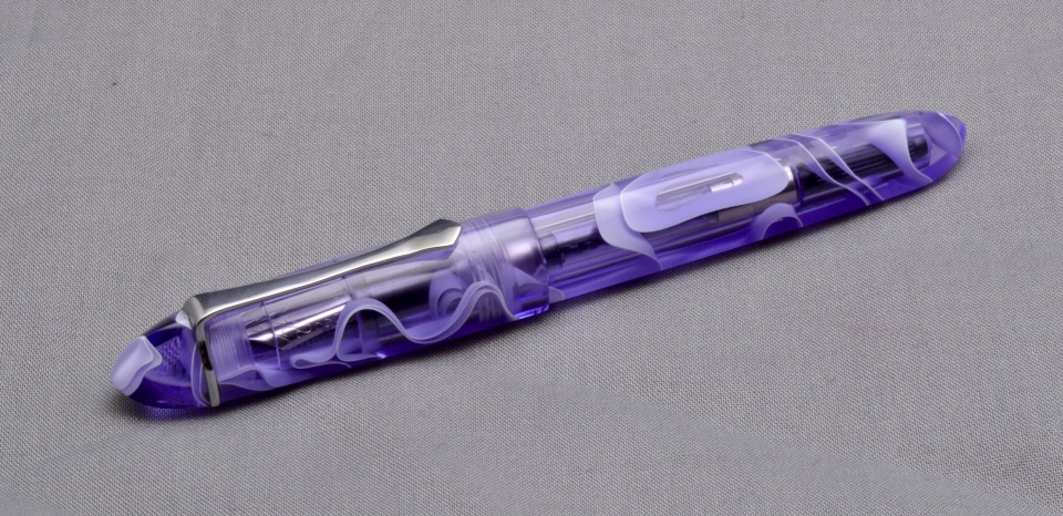

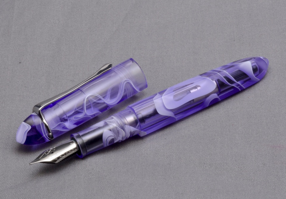

2. This is another sculpted pen, which I made on a whim because I really like this material. It's "lilac water" acrylic that I bought from Beartooth Woods. It is fitted with a Jowo #6 nib. The clip on this one is stainless steel as well.

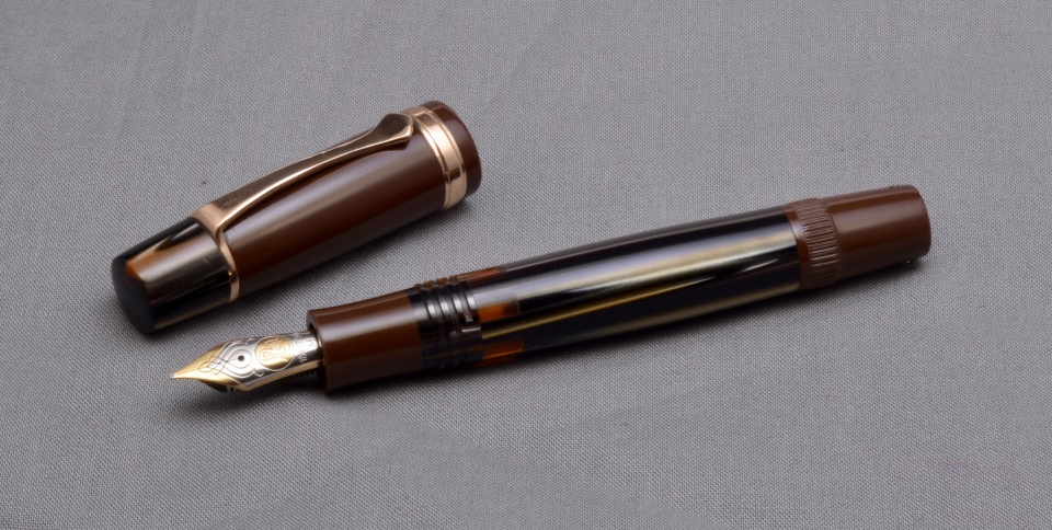

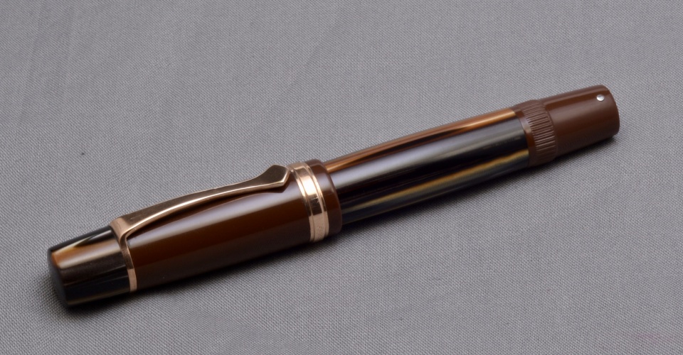

3. This pen caused me a whole lot of grief--mainly because it uses a piston filling system that I had been working on, and finally got the chance to build. After three iterations, I finally got the mechanism right. It is made from a strata gem acrylic, and "milk chocolate" acrylic. The nib is a Pelikan M800 (I really like this nib), and the cap band and clip are bronze. I had some serious vintage European vibes running around my head while building this, and I feel like they really came through. I feel that this pen is quintessentially "me," as it embodies all the design aspects that I love.

Thank you Mark. That last pen is my favorite too. It's the perfect length/diameter for me, and I've been using it all week at work.

The knurling on the last pen. Did you actually run a knurling tool against the part or did you index it and cut it in some fashion?
Thanks Pete. I used a cheap knurling tool I had, however I ruined the first blind cap I made because I didn't go about it in an intelligent manner. I wish I'd had a wheel for my tool with a finer, sharper knurl, so that's probably going to be a future purchase.
