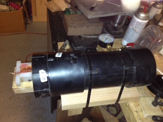

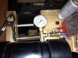

Nice to know there are others with too much time on their hands...and I found scrap materials and made a pressure chamber....not sure how much psi abs piping will hold...however...cast my first cactus....will turn this week.

Based on charts on this page ABS Pipes - Pressure Ratings I would not ever go above 75 psi. PVC is rated for several hundred psi if you need more. Flip side: when I was casting I used 50 psi and never had a bubble.

Just a side thought here. Pressure is pressure, but since water is barely compressible, but air is highly compressible, then a failure from excessive air pressure is far more dangerous than a burst from water pressure. Just a consideration for factoring in on the safety margin.
Very true, Dick. That is one of the reasons I stated my "max pressure" at lower than the lowest on the chart for the 3" pipe he is using. I tend to be Very conservative when it comes to safety. I like all my "bits" right where they are.

thanks...solid place for information...I had it at 40-60 ...I still have a minor leak at the threads...I was thinking of fixing...but now...I will leave it there...that way...it will only pump more every few minutes and not have a risk of overpressure...since I throttled the PSI to 50....now i just need to figure why after four hours...at 60 degrees the alumilite was still pliable...guess I will let it sit over night for now on....

Remember to that the pressure rating on PVC is fluid only!!! It is not rated for air and that is why there have been lots of threads admonishing this practice!!!
