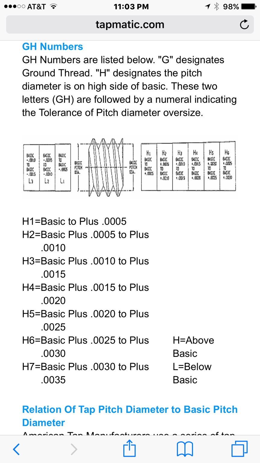

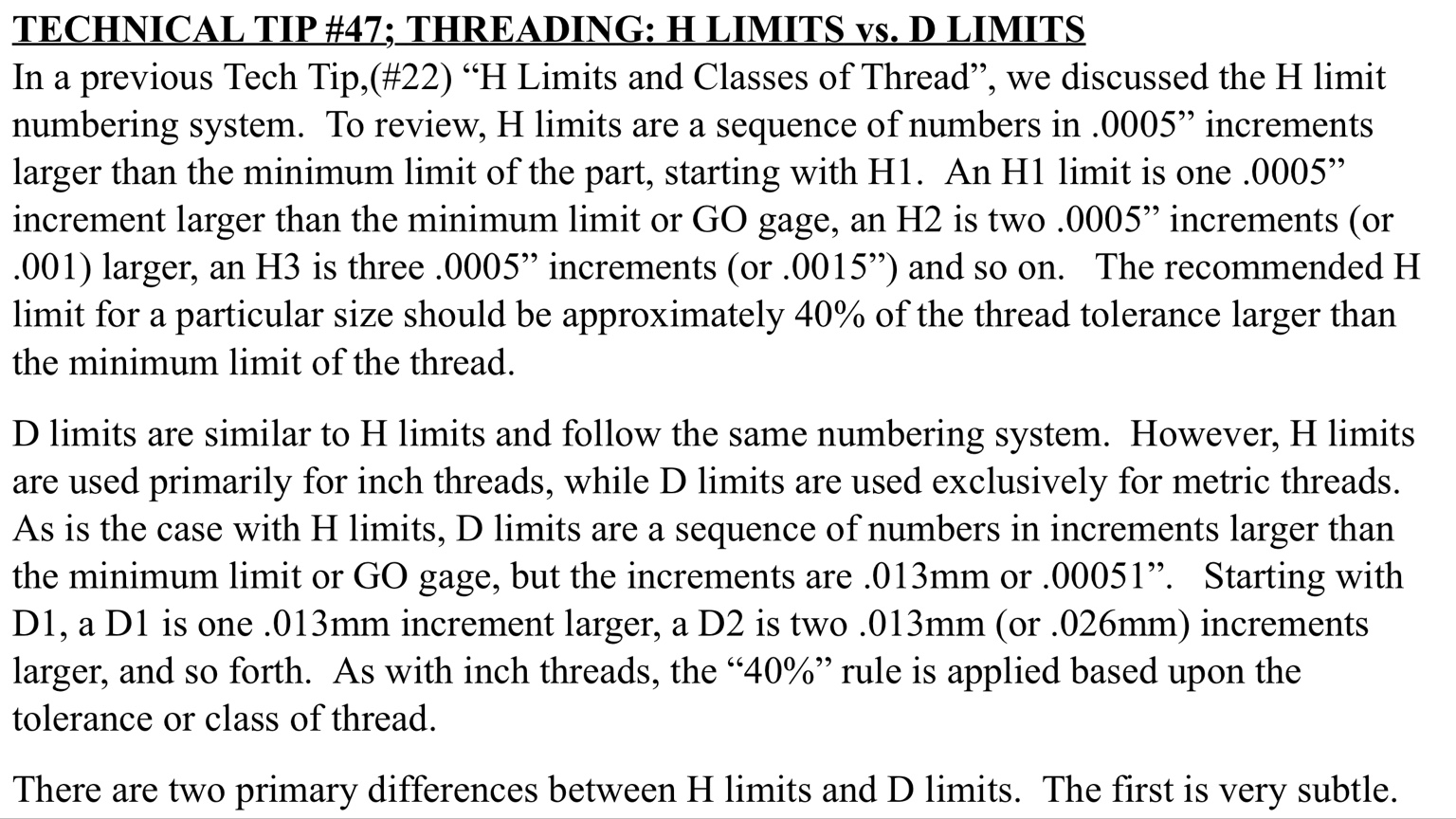

I have two triple start taps both M13x0.80 6H HS. One is marked with a GD-4 and the other GD 5- What is the significance of the GD 4 or GD 5?

This may help you. Short answer is 0.013mm difference. In all practical purposes there is no difference as both will do the job nicely.
