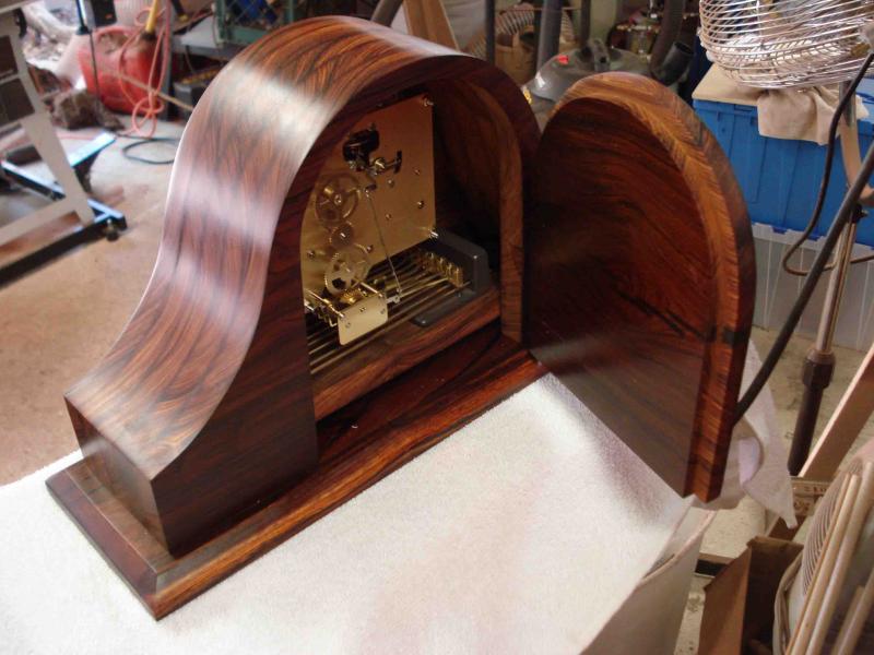

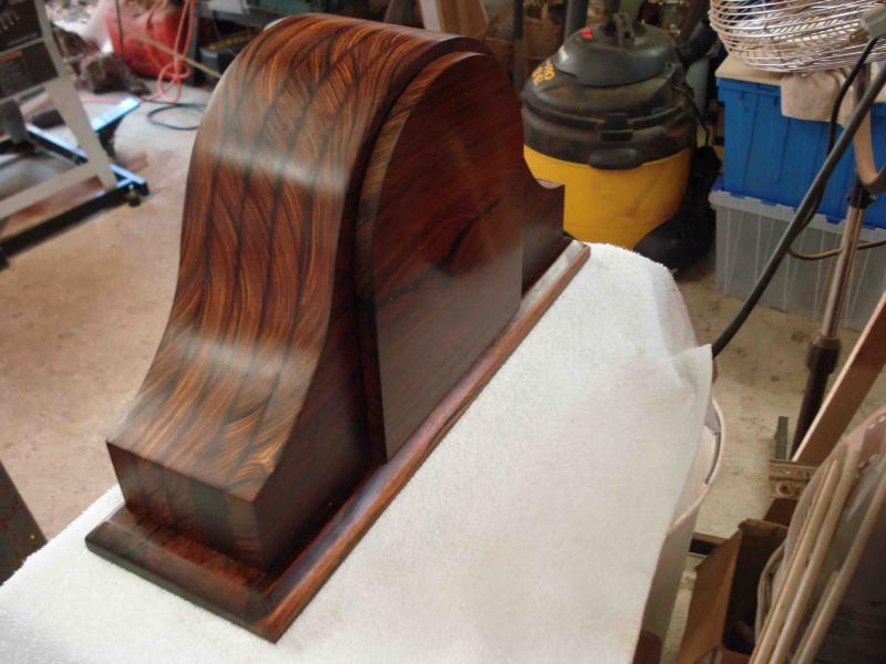

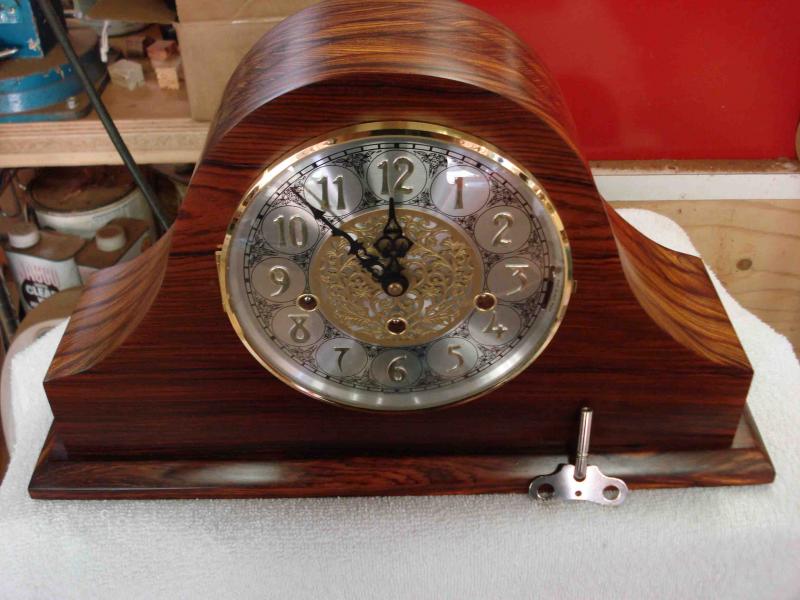

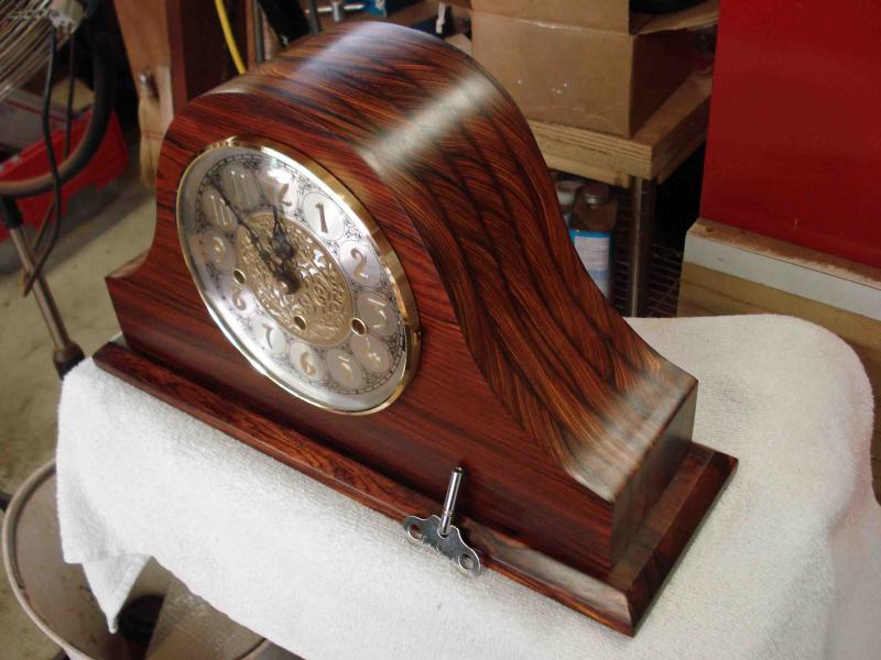

I recently got an order for a clock from my sister in law. She specified a mechanical movement and cocobolo. I installed a Hermle triple chime movement and made the case from laminated cocobolo. There is no veneer in the clock. I hollowed the inside by cutting each layer prior to assembly. Finish is tung oil hand rubbed to b ring out the low gloss.
The clock came out beautifully and she was very pleased.
Completed clock 1.jpg Completed clock 2.jpg Door open completed clock.jpg Back of completed clock.jpg

Are these your designs you are making or are you looking at photos for ideas??? The reason I ask is if you are designing them and now this is just a suggestion, you may want to stretch out the sides abit more and get creative. The reason for this is because this is a mantle clock and the face you are using is rather large compared to the surounding wood. To accent the wood more is to show more. It would look more sleek instead of boxy. Now this is just a thought. There are many shapes out there including ones with scrolls and what I call roofs or tops. Very nice work and love the wood. Thanks for showing.

Thanks for the suggestions. I always try to listen to others to see what they might offer. Those are great words from someone who obviously knows a little something. Stretching out the wood sides is a fabulous idea and one I will use for the next clock. I had already cut out the initial parts and got the clock face after. This was only my first clcok to make from scratch. Fun though I was concerned over my abilities. I have done kits but nothing quite like this one. Usually they are veneers. I like the solid wood look better.

The gong unit came with the movement kit I bought. It is eight brass rods that hang below the movement. The hammers had to be bent to align with the gong unit to make it work right. The movement can be found under the movement kits section. It is the Hermle 1051 kit and includes the face, hands, gong unit, and movement, and bezel with domed glass.
