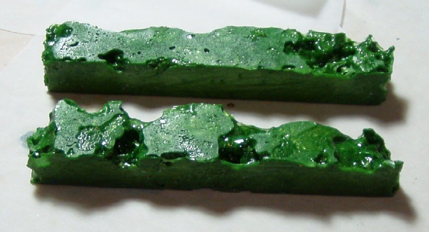

For PR(polyester resin) you have to patiently wait for critical moments as it starts to gel.
Here is a nice example of turning my back and writing my notes on this batch. It went from being just nice thin resin to jello in just... well suddenly.
I had to chop at it with popsicle sticks to try to get it into the mold. If I had been thinking on my feet I would have chopped it up, thrown the bits on some parchment(siliconised paper) then mixed an ounce of some other color and dropped them in that- then forced them into the molds. The fresh resin would have filled the voids and givin some interresting contrast.

I've got one like this too, but I didn't cut it up or anything. I was just going to toss it, but thanks for the idea! It was a neat copper and black one.
No offense - I need the GOOD mixing stories. he hee:D

Don't waste it, put it back in the mold and add a good contrasting color. It should be very interesting then.
What doesn't make it into a pen or a purse perfume will be used for something. I am a firm believer in waste not.
Although the one with all the voids may just get a new color(s) added just for the fun of it.
