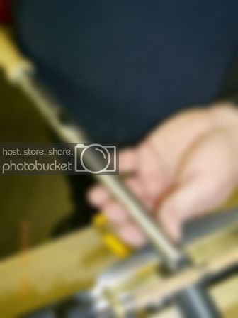

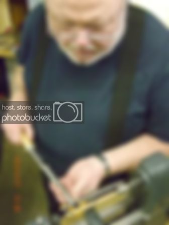

Hello again from Sweden.
Yesterday I got the pleasure of testing the lathe tool as it connects to a vacuum cleaner. It works fantastically well so I bought one immediately. The entire tool has a length of 50 cm and the diameter of the tube is 17 mm. The outer 5 cm is made Swedish HSS with a really sharp edge and the rest of stainles steel. A big advantage is that the steel with the air stays colder than usual so that the edge will last longer because it does not get hot. You can buy a special jig for grinding to make it both easy and perfect. I would not discuss any price here on the forum and I hope you respect it. I put the email address of the company, so you can email yourself and ask for more, you who think that it looks interesting jarl.cederblad@telia.com
Mr. Jarl Cederblad, thats his name, has now patented in the USA. He is a lecturer at Umeå University and educates crafts teachers on a daily basis.
I enclose two pictures so you can see how big the tool is in my hands.
Sincerely / Urban
