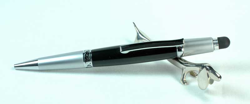

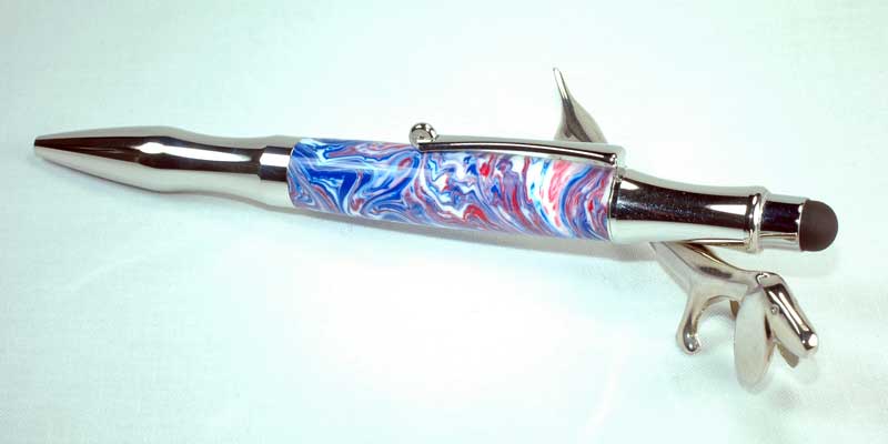

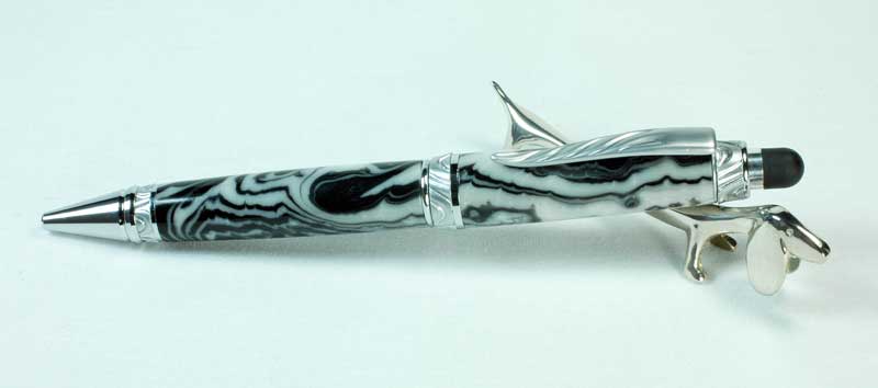

The stylus tip from CSUSA can be easly fitted to the Elegant Sierra, Cigar and Virage. Probably many others but these are the only ones I have done.
