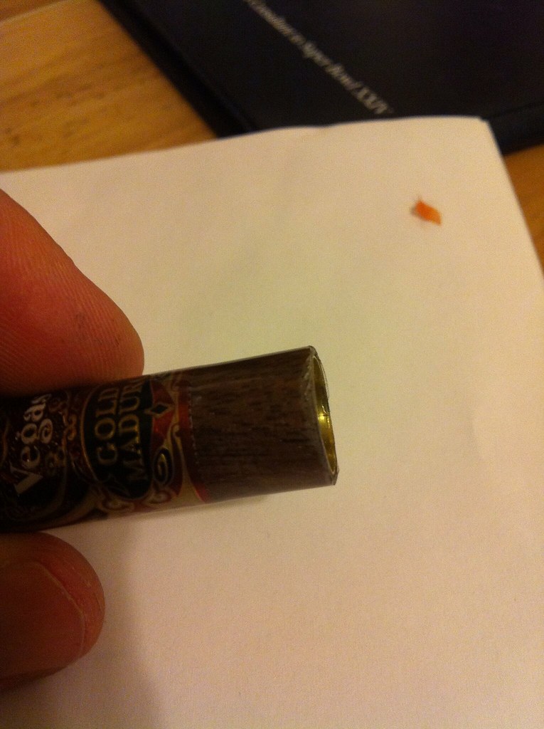

On all the pens I have made with CA, save one, the glue has not made a clean break at the body of the blank, and I am left with a white line at the ends of the blank.
This pic was for another experiment (failed overall) but shows the issue I am having. How the heck do I fix this in the future.
Tonight I ruined an otherwise really nice body with this issue, and it is ****ing me off. HELP!

I have found when I only apply 3 coats it's not as bad, but have not completely found a solution yet, let me know if you do.

Do you leave the bushings on to apply the CA? I'm guessing you use a mandrel. If you do, try removing the bushings and putting some wax on the bushings before applying the CA. Or If you have 60° centers, you can apply the CA between centers without bushings. This is the way I do it, and I've put over 20 coats of CA on a blank without a problem.

Do you remove your blanks and put just a smear of vaseline on the bushings so the CA does not stick? Then put blanks back on mandrel and apply CA.
Also, before removing the finished blanks run a very sharp blade between the blank and the bushing. I found an exacto knife works.

I used the diamond and small parting tool to cut the CA down to the bushing just at the bushing/blank joint. This made separating them easier. This worked except when I was using oily woods such as ebonies, cocobolo and the like. I often had trouble with lifting and the "white" showing (because it lifted) when separating. Since I did quite a bit of those woods, and had the lifting of the CA a little too often to suit me, I changed to TBC and haven't had any problems since. That was back in '07 or '08.

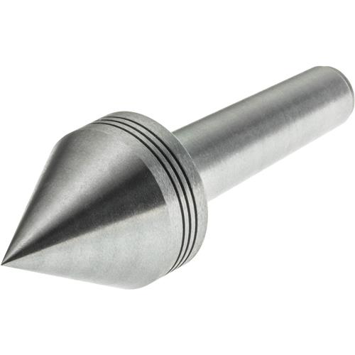

60° centers are the live center on the tail stock ends that go into mandrels. Most lathes come with a center for turning wood. The mandrel is metal and the dimple in the end is made for metal lathe centers. The wood centers tend to wallow around inside the mandrels.
That is what a 60° center is.
Now Part 2 to that. In the last three or 4 years JohnnyCNC has made bushings with 60° cups in it for using in Turning Between Centers (not using a mandrel). In this case, 60° centers are needed on the tail stock end (use with LIVE center) and head stock end (Use with dead center).
However, if one has the bushings for mandrel use, these can be used with just about any live center. Contrary to what most people will tell you, you do NOT have to use 60° centers for standard bushings to turn without a mandrels (TBC).

It kinda looks like the CA has seperated from the blank upon removal of the bushings. I have experience this on occasion and have solved the problen by turning between centers BUT...that doesn't solve the issue with the faulty blank. I have found that if I carefully apply a small amount of thin CA to a piece of waxpaper and then place the end of the blank in the CA the seperation goes away. Your results may vary.

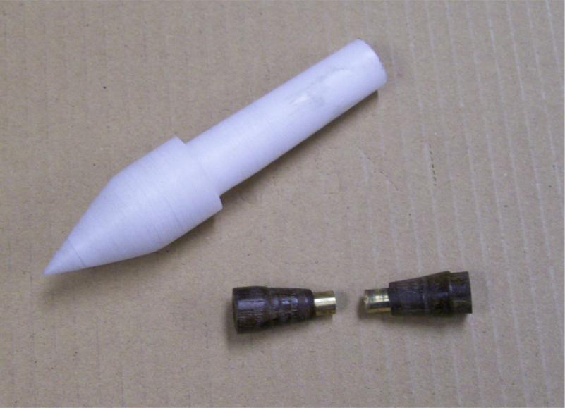

You can make your own dead center. Delrin is idea choice. Here is a simple dead center I made with delrin. Also shown is a set bushings I made for center turning on a mandrel. Both very simple to make. I use the dead center all the time. I use it for applying CA, polishing, sanding, etc. I also use it to sand the brass tubes, very quick and easy. I never have a problem with the CA. As stated before in this thread, CA will not stick to Delrin.
