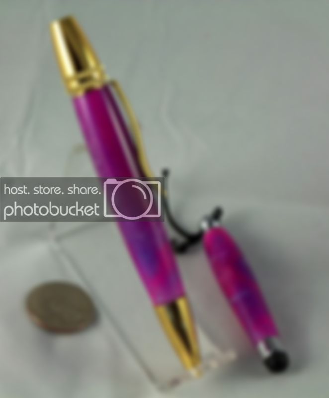

I made about 20-30 of these thingsfor xmas using the credit card pen kit from PSi and the stylus tip from CUSA. I also made a bunch using the 1-3/4" scrap cuts of my blanks and the tip and earphone connector fro CUSA it makes a real nice small stylus they can plug in to the 3.5MM earphone hole of their phone or tablet and not lose it. A perfect size for the phone a standalone stylus. Otherwise a pen/stylus combo is the best.
I converted a bunch of leftover chrome acrylic slimlines with stylus caps and they seem the best compromise as they use standard over the counter refills. On the credit card pens I supplied a refill with every pen since the refills aren't that easy to get.
I also used the 7mm pre-drilled pearlessance white blank from PSI which seems to match the whole white iphone crowd. The females especially liked the small pearl pen/stylus combo. You have to keep them around $15-$20 which is the going rate for these things everywhere else. They made great last minute stocking stuffers this year, i was surprised how popular they were. I think I'll do some in breast cancer pink as well this year. That seems to be another popular coloe with the ladies.
oh by the way for an extra $5-$10 I threw one of the micro phone stylus's in with any acrylic twist pen purchase this christmas. seemed like a nice combo. Buy a pen and get a stylus for not that much more.

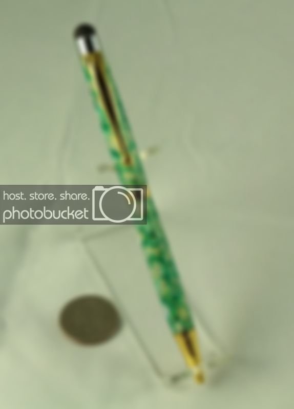

converted slimline
combo using scrap for stylus
