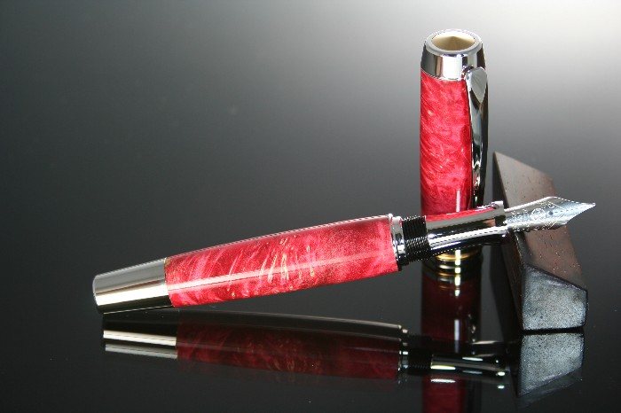

Burnishing a turning is usually only done to raw wood, not wood that has been finished. People that like the natural feel of wood without any surface finish added, will burnish with shavings. I use to do that with a lot of my Walnut turnings years ago. If gloss is what you are after, burnishing can be one of the steps you execute before application of the final finish of your choice.
I use a 10-15 minute CA finish on all my wood bodies (sometimes takes longer on a difficult piece, but not often.) and this is my end result.
