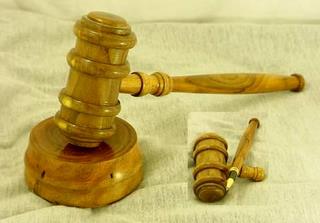

This isn't from the same kit, but I think its the same principle that Eagle is giving instruction about. Hope this helps.

That is exactly what I was trying to describe Don though I would normally use a contrasing wood. Personal preference.

I agree, contrasting wood for the CB, but this is the handle from one of the gavels I make with a pen in the handle. Like this:
