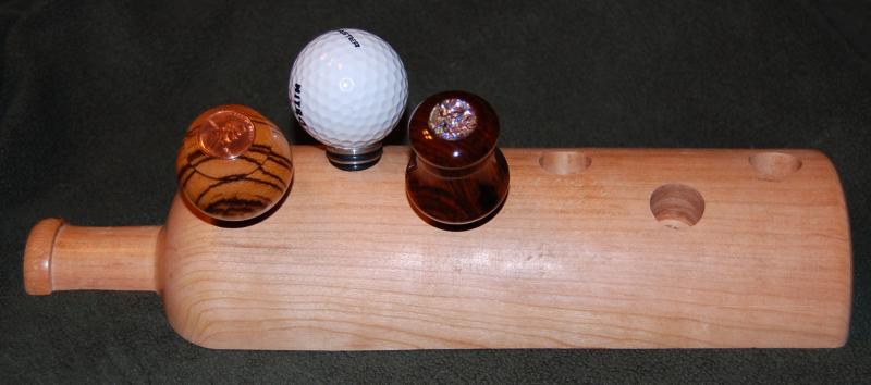

Got this display idea from a Terry Achey post on SMC a year ago. I turned an old cherry log down to a wine bottle shape, then cut it in two on the bandsaw, then flattened up the base on the jointer. Did a few bottle stoppers along the way. Waiting on some more stopper blanks to fill this (and the other half) up.
Thanks for looking!

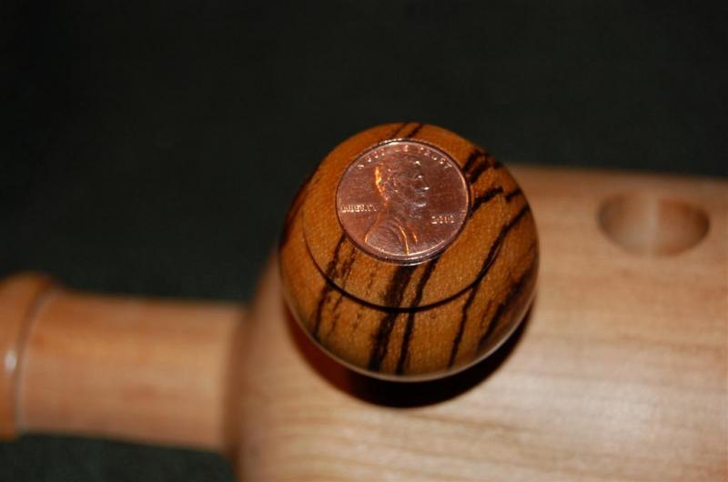

Marblewood with a penny insert:

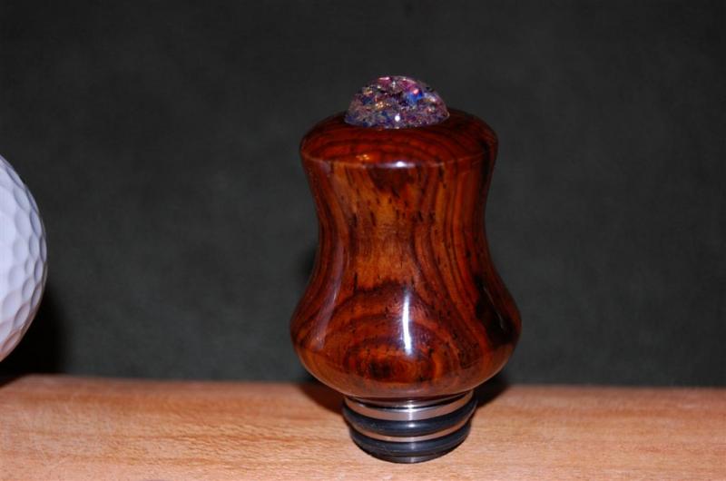

Cocobolo with glass insert from CSUSA:

Thanks, guys. Read the first line above - I borrowed it already! :rolleyes: I just like to give credit when I do (and when I can remember from whom).
The guy I "borrowed" the idea from used a "whole bottle" with legs - I just cut mine in two. He had 4 holes along the top, I opted for 6, alternating sides. I wanted to see how this works before I drill out the other half.

So it is sorta your idea.....:)
Thanks for the change, I think it's probably better that you can get two displays out of one bottle.

Rob, I glanced at your site and notice you use longer bottle stoppers (I use Ruth Niles'), so I don't know how the "half bottle" would work - it may not be deep enough. Although, looking back at Terry's, he leaves a lot of metal sticking out.
