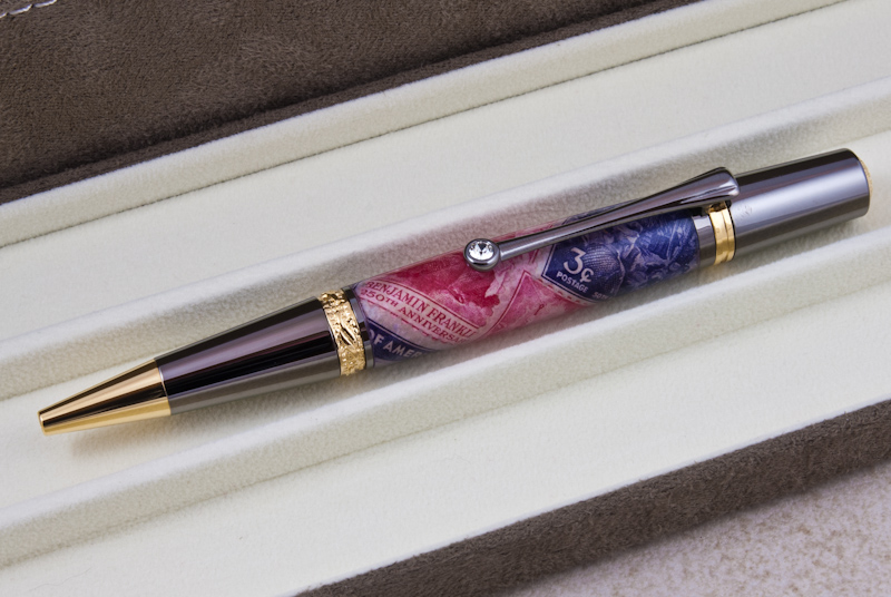

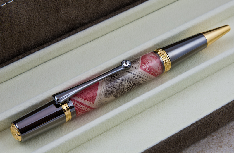

Here are a couple of my recently finished stamp decoupage Majestic squires.

Love that pen. So would my mother......Do you live anywhere Thomasville, Ga.
Just kidding, I need to make one of those for her.

Sweet. Did you CA over top the stamps before casting?
Yes, I did. The resin will eat them up if I don't. What I have discovered is some stamps (the reds ones mostly) are very sensitive to the polyester resin. Also, the older stamps are very fragile too. The CA protects them. I find that the cancelled Washington 2 cent stamps are about 1930 vintage. When you think about it, that pushing 85 years old - so it's really just an old scrap of paper.
I've been using mid-twentieth century stamps because I like the single color look.
