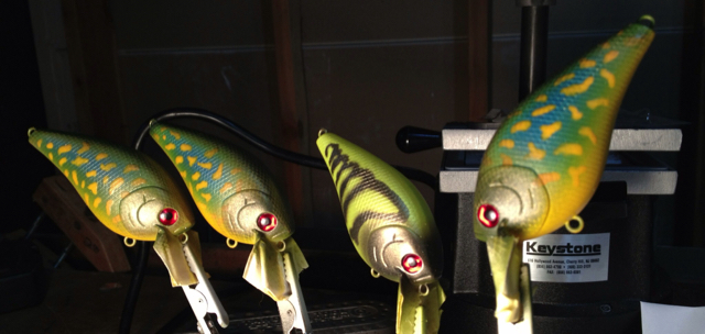

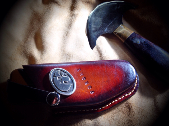

Skie,
That's correct and I did it that way for a few cans, the expense is what got me to switch to the airbrush. If you own a compressor then it's big enough for an airbrush. You can spray about anything through them if you can thin it. Most of your 99 cent craft paints work well. I spray stain and dye too.
It's as easy as spray painting but you can afford a lot more colors for a lot less money than buying cans at 3 bucks and up for one color. You can mix colors too.
First one is a leather case I made. Water based dye from an airbrush
Second are some lures I rehabbed with water based airbrush paint.
Sent from my iPad using Penturners.org mobile app

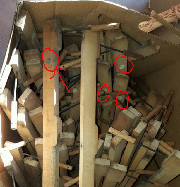

I went that route too. I cast my own bullets and jig heads. I have a plumber friend that has literally given me about two tons of lead. There is a lot of time involved in making a wooden lure that works. I get why companies don't use wood much anymore. I also get why a good Musky Lure starts out in the $20 range and goes up.
My brother restores pianos. Each key on a good old piano is balanced. They used lead to balance the keys and a large percentage of the keys have round lead slugs in them. Looks like short sections of cut off lead rod. All sorts of weights in one keyboard. The early turn of the century pianos often had mammoth tusk keys on them. Real thin veneer or ivories as they are called. There are also celluloid keys out there too, flame testing will tell you if it's tusk or celluloid real fast. If you are brave enough to do it there are free pianos out there. Most of the time folks just want them gone. If it's a player piano look under the hood, many of those have hundreds of lead tubes that feed the action.
I would never make wood lures to sell. The time involved would make them very expensive lures. I do enjoy making them for friends and family. It's the same with pens. Never sold one and doubt I ever would I just enjoy the tinkering.
I love fishing but I do not like fish or seafood at all. I can't even say I get food from my hobby because I won't eat it no matter how good
people tell me it is.
Lead slugs for balancing keys.
