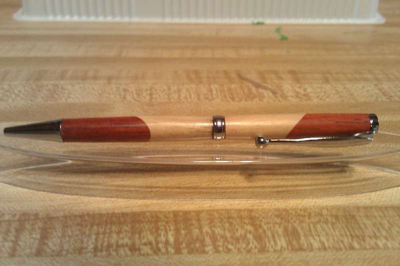

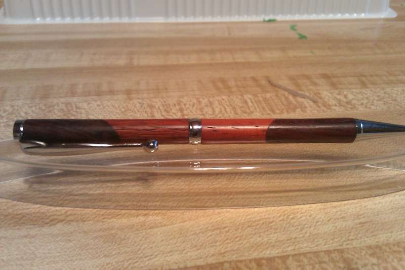

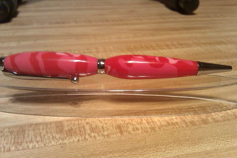

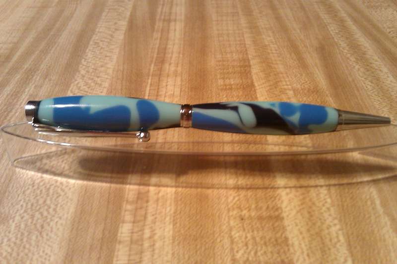

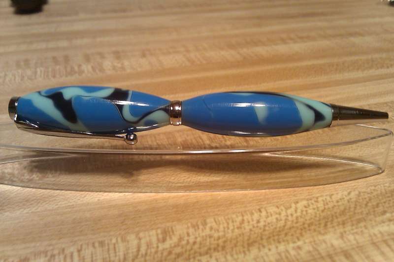

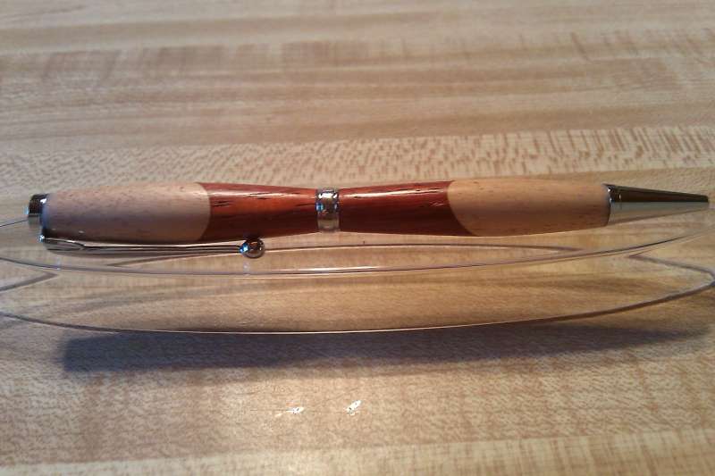

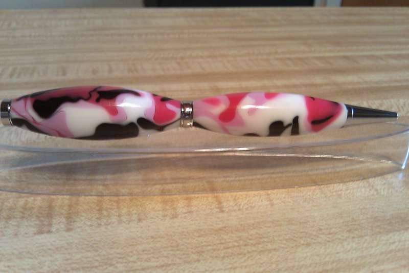

When I got my lathe, I ordered a bunch of slimline kits with it (And no other style kits). I quickly got bored with the straight cuts, so I started experimenting...here are the results of my first week or so with the lathe.

That's some nice work. As a fan of the fat body slimlines, I can't believe someone managed to get away with a fatter bodied slimline than even I was willing to try. Well played!

Thanks! I wasn't sure if the clip would still go on (And not look wrong) with such a fat body, but it did. I did bend the clip on the pink/black/white one to make it lie along the body, but other than that everything still fit perfectly. All of the acrylic fat bodies were given as early Christmas gifts, and they were much appreciated (From my mother, who collects expensive pens).

I was really proud of the fatter ones when I first did them, because they didn't look like total garbage when I was finished (Which is what I was afraid of). Now that I've done a different style kit (The Designer NT from PSI), I feel like those ARE garbage, and if I wanted fat pens I should just have bought fatter pen kits :p
Isn't that the way with learning a hobby though? After a while you look back on your early creations and critique yourself based on what you know now, that you didn't know then.

Dude, those slimlines are totally not garbage. Those extreme fatties really look like retro art. They really bring old 60's style to mind and actually look good as they are displayed on the holders in the pics. I would have that on a desk at work. If I had a desk job. When I have a desk job in a few years.
