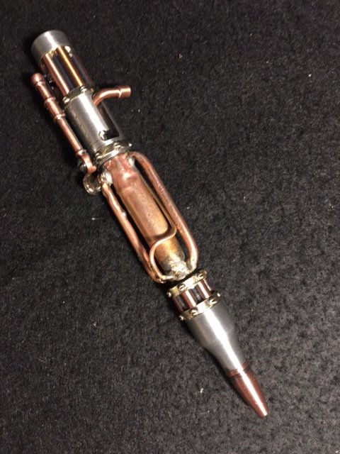

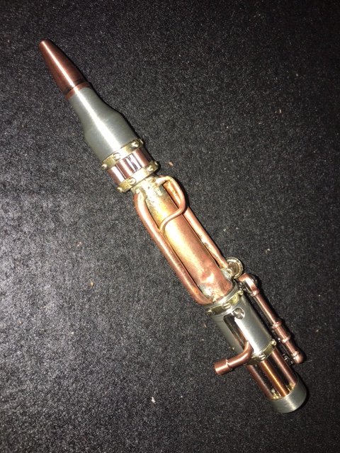

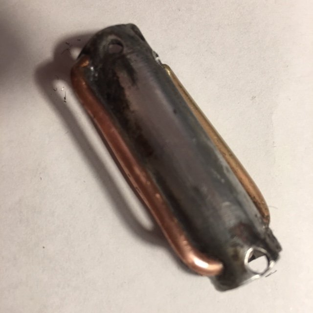

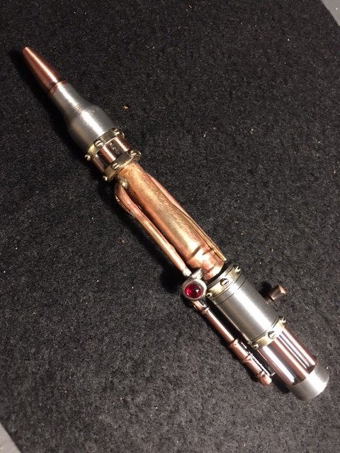

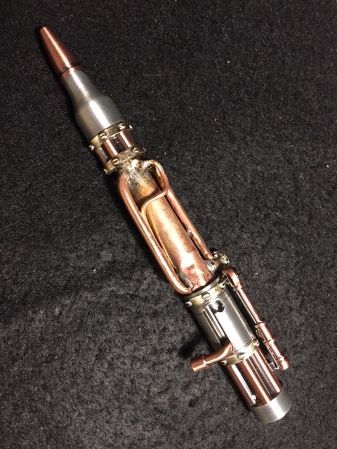

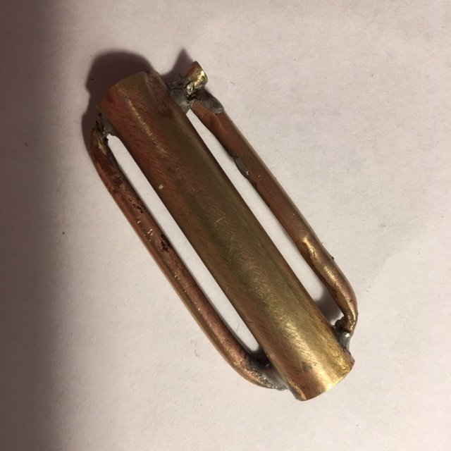

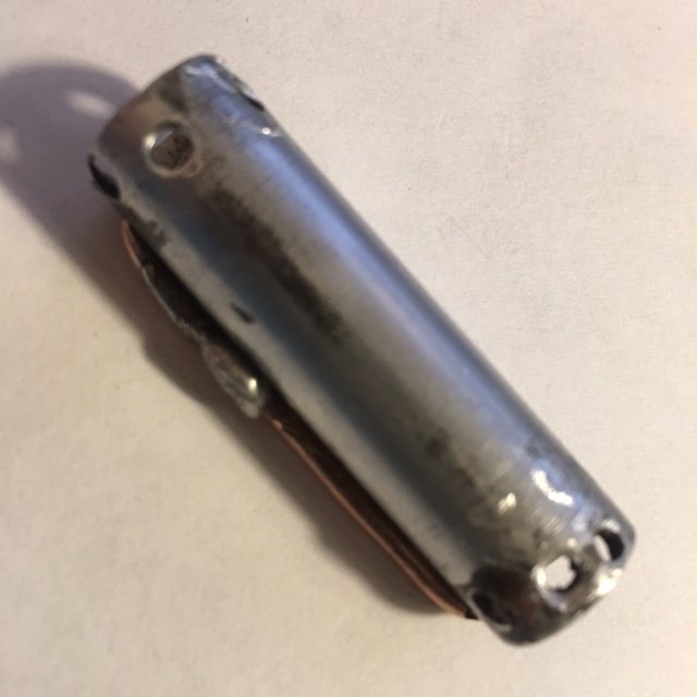

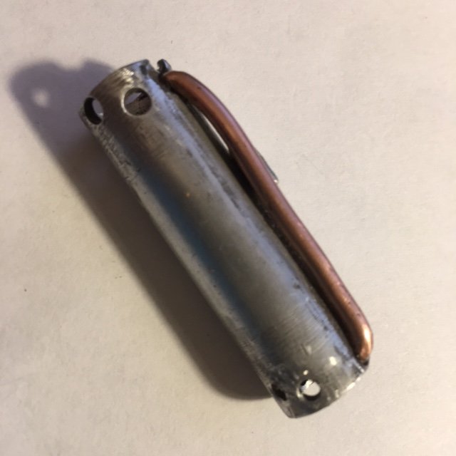

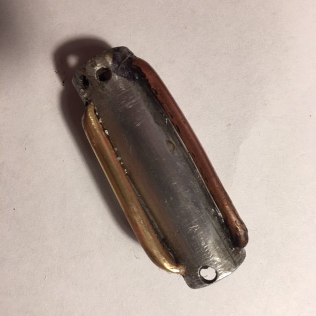

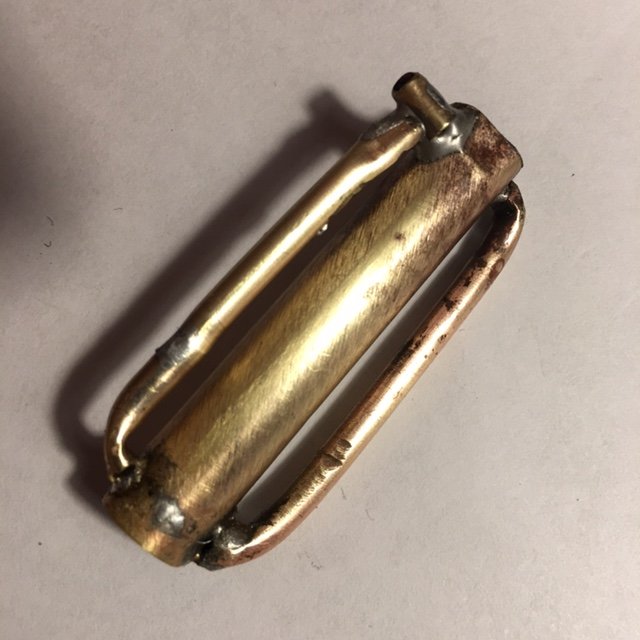

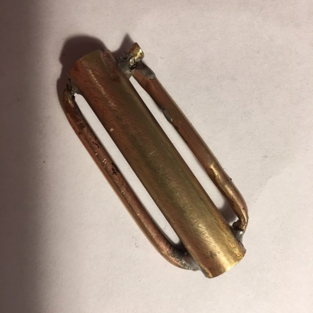

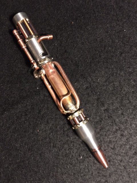

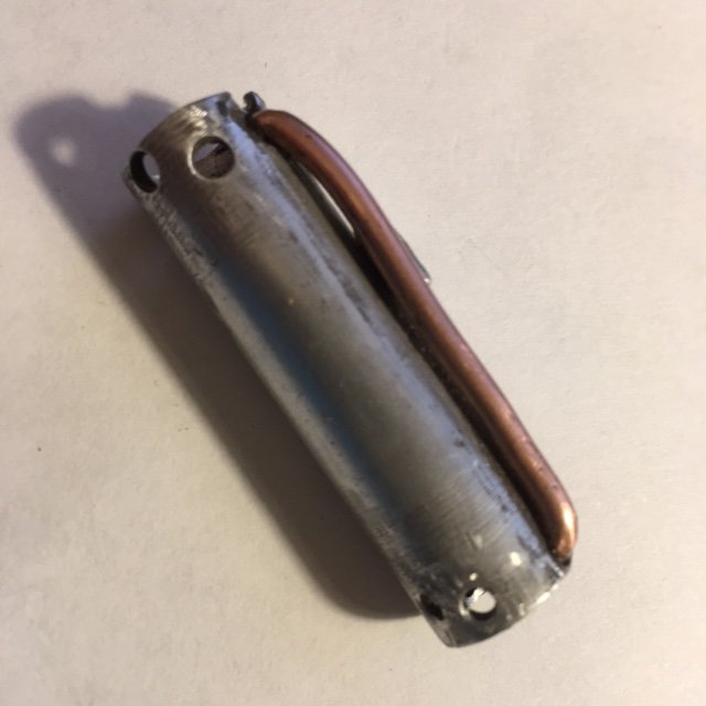

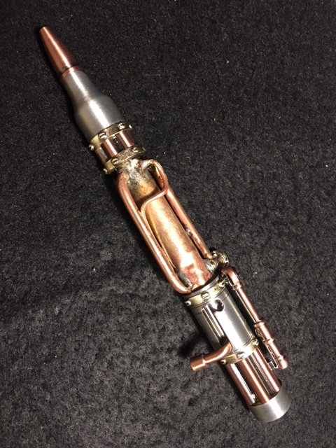

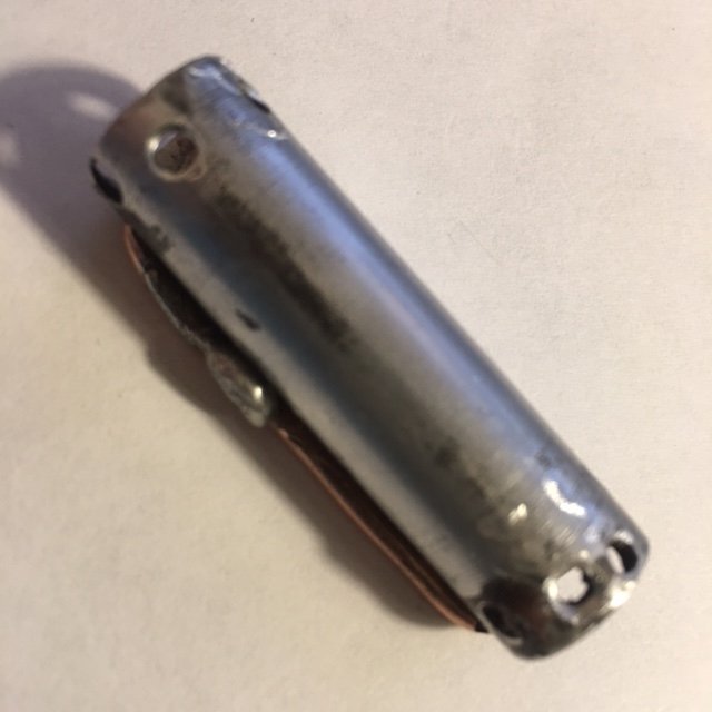

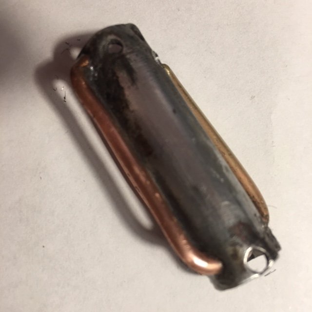

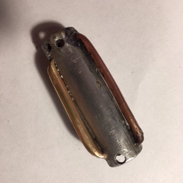

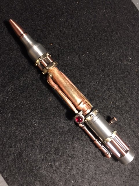

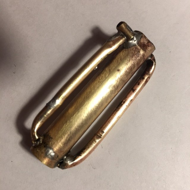

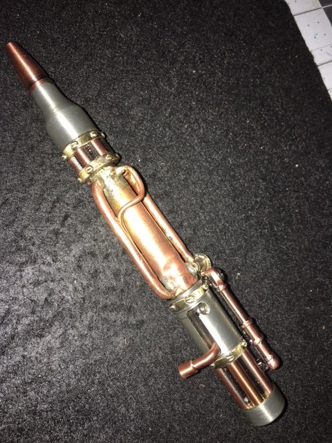

Yuppersl tried all after noon to solder, copper to aluminum, brass to aluminum, brass to brass. I was almost successful with brass to brass but need to be more carful with cleaning the area and which flux is the right one. I can understand why these are few and far between. No one we visited today carries Uniweld products so need to find a welding shop or order it on line. Tried some aluminum solder but all it did was turn red and would not flow.
Don't laugh. This is a protottype alilminum with copper wire.
