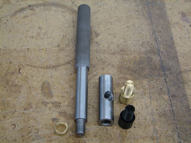

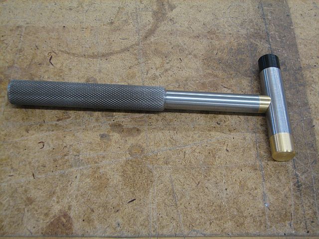

It's raining cats and dogs here in western NC so I couldn't cut the grass, I was kinda bored and decided to make me a hammer for knocking around the lathe. I thought you guys might get a kick out of it.......
attachment.php
It's made from the same 5/8" tool steel as my tool rests and has replaceable brass and Delrin tips.
attachment.php
It's real easy to make and it's perfect for beating on things that you don't want to get all boogered up.:biggrin:

What do you use it for? I've only had my metal lathe for a short time, but I haven't run across a need for a hammer yet...
You should watch me work sometime...if it doesn't fit.....:biggrin:
All kidding aside, what I use it for the most is centering pin chucks in my metal lathe. I use a standard 3 jaw chuck and the pin chuck sticks out about 3", I put a dial indicator on it and "KNOCK" it so I have a max. of .001" runout at the end.:wink:

I use W-1 tool steel because it's the cheapest, mind you I'm not "cheap" but I sell my tool rests for very little $ as a service to my fellow IAP members and I need to keep my costs down. Even though W-1 is the cheapest of the tool steels, it's still a tool steel and is very good for what I do. The hammer is made of the same stuff and is not hardened because you don't hit the steel, you hit the replaceable faces.
It's not polished either, that's the look I get right off the lathe.:biggrin:

Thanks Rick...I was already placing an order for some aluminum and brass yesterday so I wanted to add a piece of tool steel to the order. I already had picked the O1 based on the other feedback. I spot checked prices but there were 7 different types of tool steel and I never got down to W1 to notice it costs a little less but I'll remember for next time. I had the same thought that it didn't need to be hardened since you are banging on the brass and plastic parts.
If you don't mind sharing how are you doing those interior threads on the hammer head? They look so nice I'm not sure how I'd accomplish that. Curious to know if it's done by hand or using a machine.

Nice job!! I would also be interested in getting one from you if you do decide to make a few.I would like to know a little more about the size and weight.
rherrell
Aug 22, 2006
6,337
Pilot Mountain, NC
Gil, the threads are done with a tap and die, I could cut them using the lathe but with standard sizes it's just faster and easier.
Jim, the hammer weighs 11 oz. and is 7" long. The knurled part is 5/8"x4" and was made to fit MY hand, of course all these dimensions can be changed to whatever you like.:biggrin:
