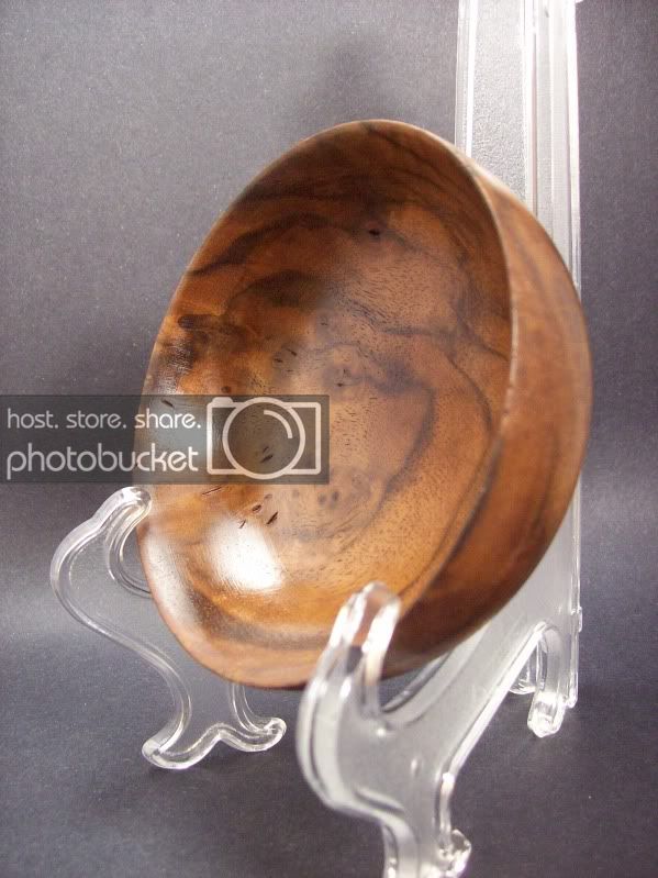

Small Walnut Burl Bowl
See more from kludge77
kludge77
Mar 9, 2009
644
Santa Rosa Ca

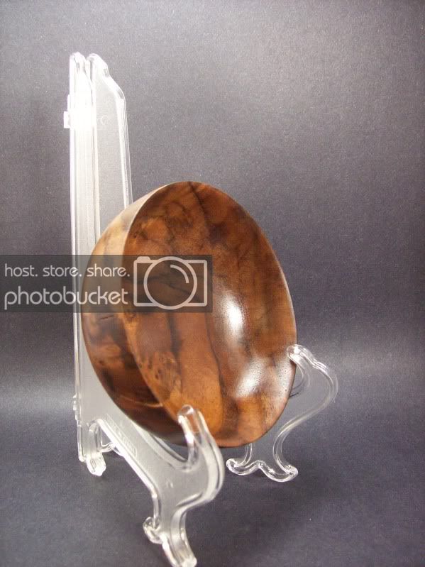

4 inches wide 1 1/4 high. Finished with Danish Oil.
robutacion
Aug 6, 2009
6,514
Australia - SA Adelaide Hills
Geezzzz mate, you went quite thin on that one, huh...???:wink:
Certainly a nice piece of wood and your bowl turning is coming along quite nicely, also...!:)
Now, you need to go BIGGER, something that will cover the stand you used on this one...!
How about that for a challenge...!:wink::biggrin:
Cheers
George
kludge77
Mar 9, 2009
644
Santa Rosa Ca
Cheers
George
Actually, it tapers to a point, so it's not a consistent thickness. Still feels pretty good in the hands though.
I totally need to go bigger, (don't have any larger blanks in the shop) but I have a LOT of smaller walnut blanks and I figured I could use the practice. I'm still struggling with the bowl gouge, but every bowl that I make, gives me that much more confidence.
Thanks
-Peter

i think if you're OK with the bowl gouge in the small bowls, a larger
bowl would be easier since you don't have the tight space to worry
about. I can see a set of these with a large serving bowl would
look fantastic in a table setting.
