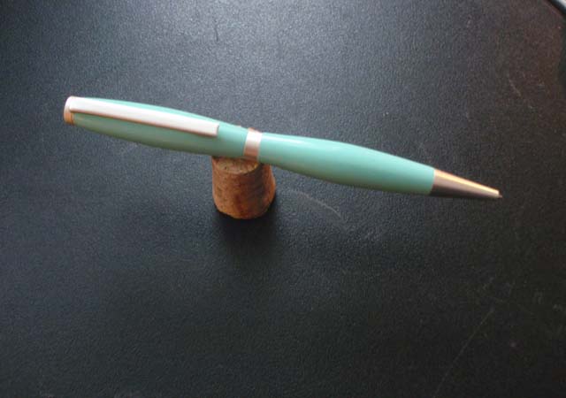

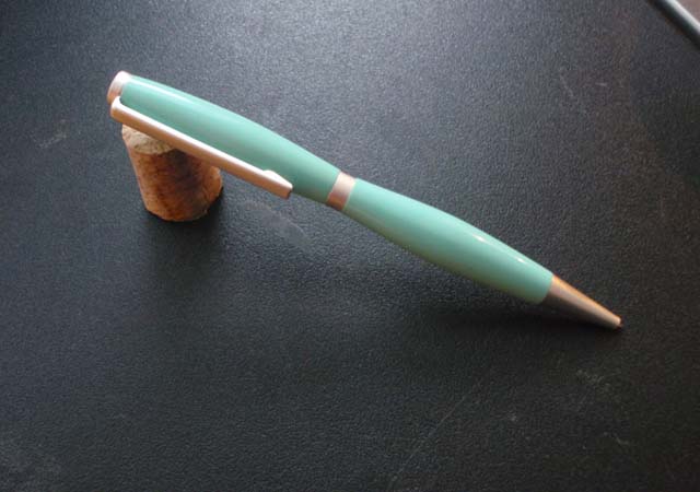

Slim line in a piece green sewer pipe. Blank compliments of Bruce119.
Comments welcome.
Lin.

Take a drive down a country road. Road graders break them up all the time. Then cut it with the bandsaw. Turns really easy and as you can see, it polishes really nicely too.
Oh, you live north of Vegas, they don't have dirt roads there! JK. Care to try some, PM me.

That is a nice color. Soft, suptle, pleasing. I would call it Sea Foam Green. It is like Corian. You just don't use the words Corian or Sewer if you want to sell pens.
